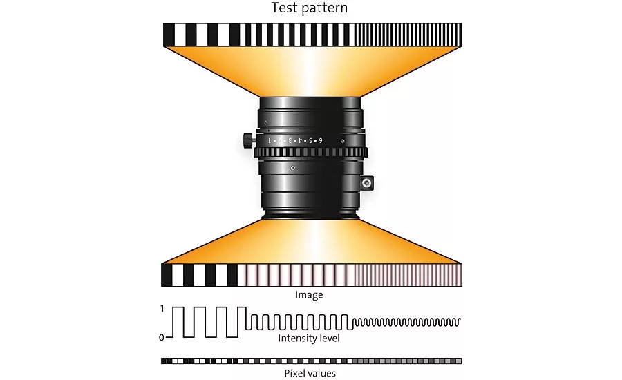

Figure 1. How the modulation transfer function (MTF) of a lens affects an image, as it is projected onto a sensor. Source: Stemmer Imaging

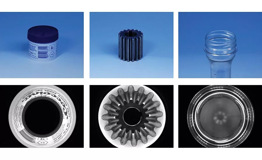

Figure 2. Imaging using pericentric lenses. Source: Opto Engineering

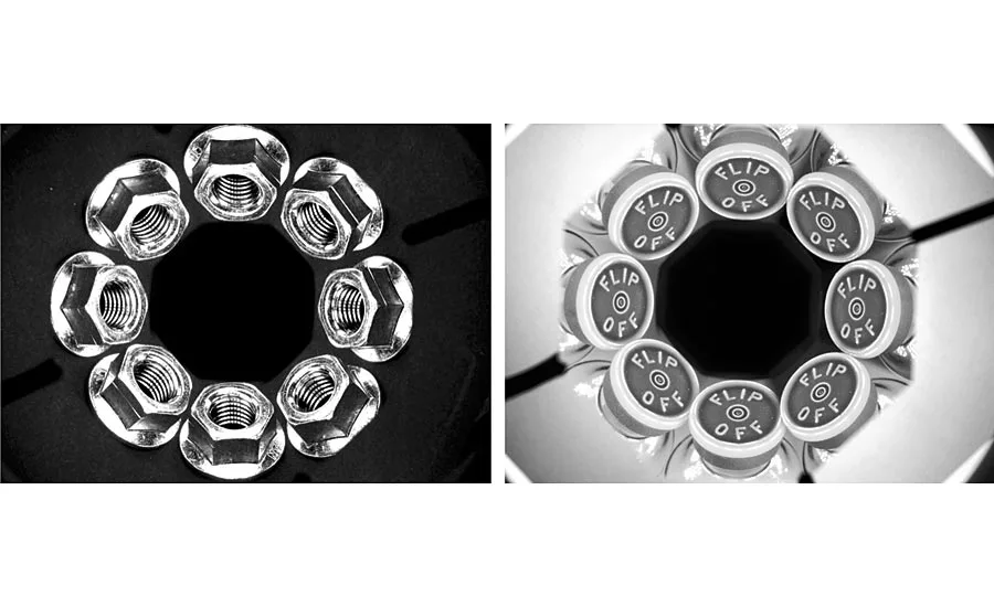

Figure 3. Polyview imaging. Source: Opto Engineering

There is a direct relationship between the sensor used in the camera and the most suitable lens. Parameters such as sensor size and pixel size are of major importance. The lens has to be able to illuminate the complete sensor area in order to avoid shading and vignetting. It also has to be able to resolve the pixel size. The better the optical resolution of a lens, the better detailed structures can be reproduced. The optical quality of a lens is defined by the MTF (modulation transfer function) relating to resolution along with the optical distortion. In order to resolve the details of an object and to ensure definite edge detection, the detail should be reproduced across about 4 pixels. Thus the required magnification is dependent on the required object resolution and the respective pixel size. The ideal lens would produce an image which perfectly matches the object, including all details and brightness variations. In practice, this is never completely possible as lenses act as low pass filters. The amount of attenuation of any given frequency or detail is classified in terms of MTF and for any lens there is a point at which the modulation is zero. This limit is generally called the resolution limit and is usually expressed in line pairs per millimeter (lp/mm). Not surprisingly, with the enormous range of sensor formats and resolutions available in machine vision cameras combined with a multitude of possible applications, there is also a very wide choice of lenses, including many specialized lenses.

Cylindrical objects such as bottles, jars, batteries and bolts can be imaged using special pericentric lenses. The specific path of the light rays through the lens means that light from the part of the object closest to the lens are imaged in the center of the camera sensor while light from further away are imaged further out on the detector. This means that a single image can show detail from the top and the sides of the object simultaneously. Common applications in the beverage and pharmaceutical industries include bottle neck thread inspection, and data matrix code reading—the code will always be correctly imaged no matter which direction it is facing. The smaller the object diameter, the larger the object height which can be inspected, while thin objects can be inspected over a larger diameter. For small objects (down to 7.5 mm diameter) catadioptric lenses are available. This lens design results in the sides of the object being inspected being observed over a wide viewing angle, approaching 45° at its maximum, which makes it possible to inspect complex object geometries under a convenient perspective.

Another novel optical configuration is offered by polyview lenses. These provide eight different views of the side and top surfaces of an object. The wide perspective angle (45°) enables the inspection of the side features of an object (for example the threads of a screw or a nut) which would otherwise be impossible to acquire with a single camera. Both the external walls of an object and its top can be imaged at the same time, while internal surfaces of holed objects can be completely inspected from the outside. A combined view of the internal and external surfaces is possible and an image displaying both the inner walls and the bottom of a cavity can be obtained.
