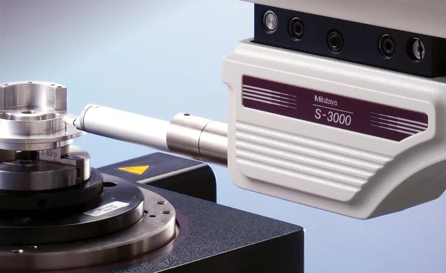

surface tester
A surface tester checks the smoothness and roundness of a tiny pin that requires exacting tolerances.
