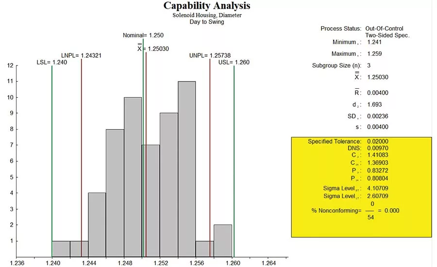

An automotive company recently changed to a new supplier for ignition solenoid housings. In the contract, the customer requires documentation of part quality for all critical characteristics be included with each shipment. One specific critical quality characteristic is the housing diameter. The supplier includes a capability analysis for the ignition solenoid housing diameter showing that all parts do meet the specifications. The capability analysis report for the diameter of the ignition solenoid housings in the most recent shipment is shown at the top of the previous page.
When the parts in this shipment were used on the production line in the automotive plant, some of the housings did not fit properly and others did not fit at all. Management’s question: “If the quality report shows the parts meet specifications, what happened?” Referring to the capability analysis provided with the shipment,
  • How do you as a quality professional explain that the data provided show all parts meet specification?
  • What questions should be asked about this analysis to understand how to interpret the information provided?
  • How do you answer management’s question to their satisfaction?
