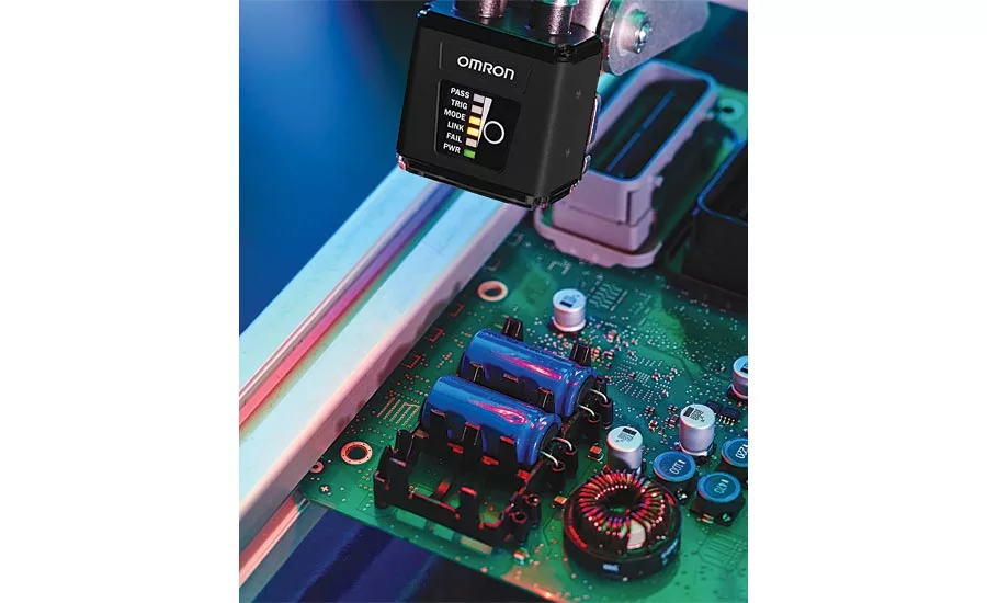

Powerful smart cameras
Powerful smart cameras like the Omron MicroHAWK series automate inspection of PCBs for accurate component placement.
