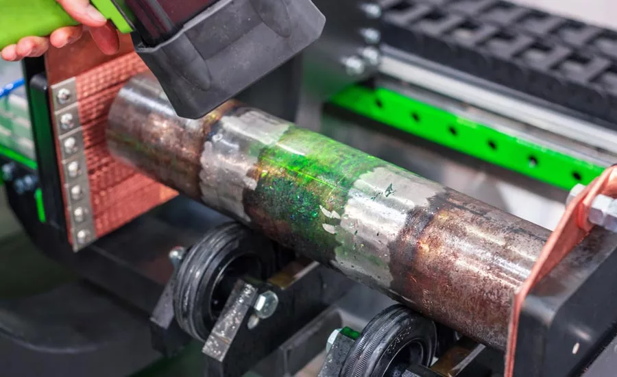

The shop environment is important as the auditor will be looking for things that could contaminate or have detrimental effects on the quality of the process. Perhaps fluorescent contamination in the penetrant evaluation area, loose particulate in UT immersion tanks, or dust, liquids, fluctuations in temperature and humidity, etc. in radiographic interpretation areas.

  • Aerospace parts undergoing fluorescent penetrant testing.
