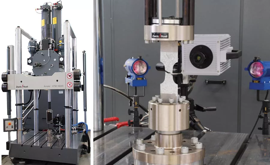

high speed servo-hydraulic test machine
An example of a high speed servo-hydraulic test machine with a high speed camera and piezoelectric load washer for testing at high speeds.

Due to their complexity, these crucial “multi-rate” tests represent a small fraction of the quasi-static tests performed routinely. If we look at pull (or tension) tests for instance, such “multi-rate” tests are performed in a similar fashion, yet require machines that can travel much faster with sensors that can provide quality data at much higher frequencies. High speed servo-hydraulic machines have been used to achieve a wide range of pull speeds covering the full spectrum of deformation rates. In these machines, conventional load cells are replaced with piezoelectric load washers to enable accurate load measurements at higher acquisition rates.
Contact sensors are replaced with non-contact position sensors for accurate displacement measurements at higher speeds. In many cases, high speed cameras are coupled with these machines to track the material sample as it undergoes deformation during the test, and thus obtain more direct information about strain evolution within the material.
