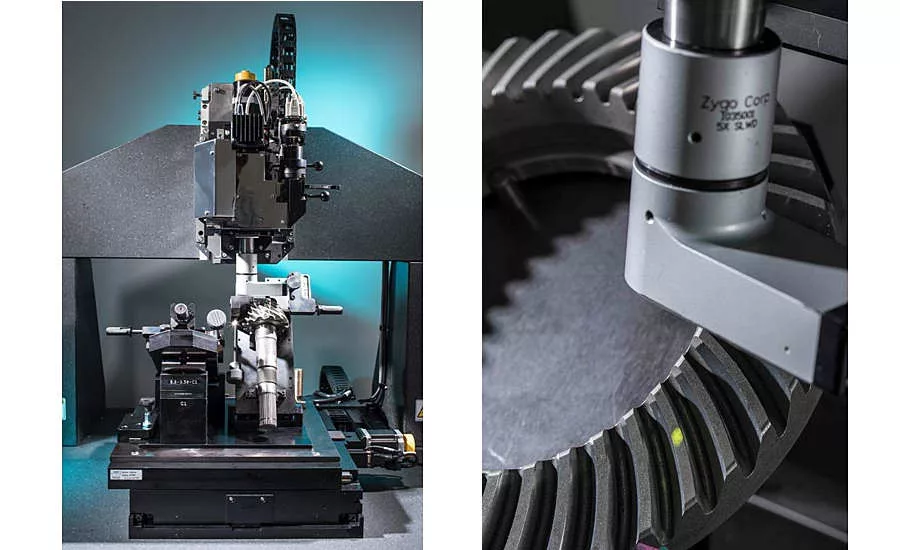

The key demand from users of optical metrology tools is for greater data density in applications that are often extremely complex. As the shift is towards in-process metrology, measurement is often to be undertaken in extremely difficult environments, which prohibits the use of some more conventional metrology solutions due to vibration or turbulence. In addition, extracting the maximum data possible from each scan is critical to enabling superior metrology on the widest range of samples.
Developments are constantly being made in the design and fabrication of profiler/lens objectives used in optical metrology systems. Profiler objectives are obviously a key influencer on the capability and performance of any solution when it comes to making field of view (FoV) larger, faster, and higher (key to efficiency and agility of in-process metrology solutions), and they also have a significant influence on other issues such as magnification and slope capability.
Vibration resistance, however, is perhaps the most important factor that influences the use of optical metrology in-process. Historically vibration has been one of the biggest challenges to getting robust metrology with 3D optical metrology instruments, vibration being seen as variations in the height surface.
To overcome this, very often the metrology tools had to be placed on heavy robust vibration isolation tables, or in a quiet metrology lab. Solutions today are being developed and evolved that through a combination of hardware and software address this issue by detecting and correcting for vibration during a measurement. This leads to lower measurement noise, more accurate measurements, and more freedom to place the metrology instrument where they are needed.
With the pressure on metrology solutions to maintain the integrity of measurement precision and flexibility in challenging environments, technologies have been developed for vibration robust metrology on optical metrology solutions. In addition, a host of capabilities such as oversampling, high dynamic range scans, and signal processing techniques that maximize the data quality and capability have been developed.
These technologies help to bring the instruments closer to the production floor and facilitate measurement of virtually any surface from the very smooth, to the very rough, and from very flat to highly sloped, stimulating in-process metrology applications.
Only through such technological advancements can optical metrology tools happily reside on the production floor providing data accurate and speedily enough to become a critical driver of Industry 4.0.
