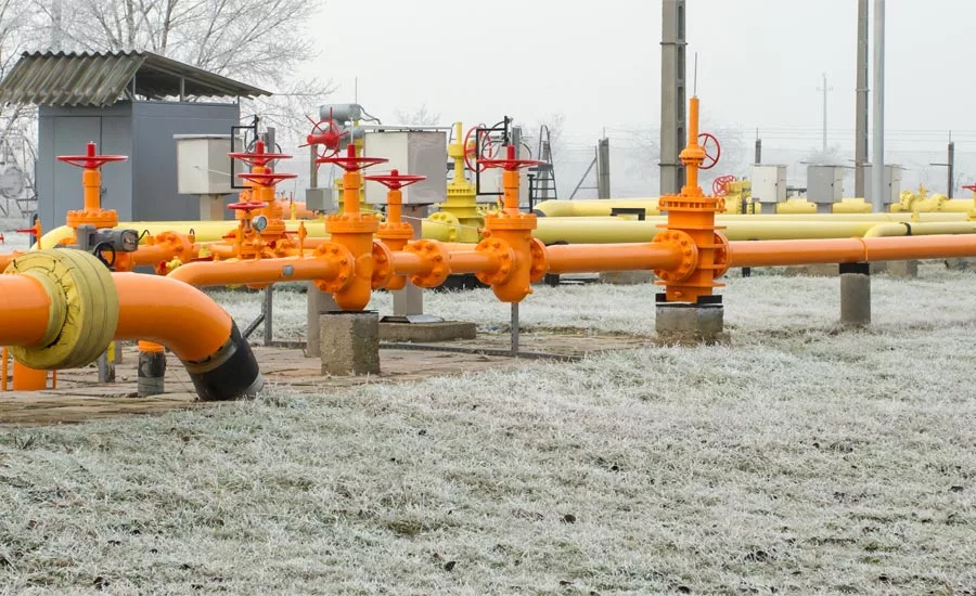

RAPA FOR PIPING UPON SUPPORTS
All piping sits on some form of support and hence all piping can be susceptible to wear through movement during operation or from a build-up of debris under the pipe corrosion that can occur. This applies to lagged and un-lagged piping.
In the past the only way to inspect these areas was to either do a limited visual inspection or alternatively lift the pipe, which is a safety hazard and financially intensive process. The process of lifting piping for a visual inspection is rigorous and some piping configurations are unable to be lifted.
With the RAPA method ALS can now screen the area under the piping where it sits on the support and determine the presence of damage, resulting in a more focused understanding of CUPS. Ultimately, this improves safety and significantly reduces financial demands.
