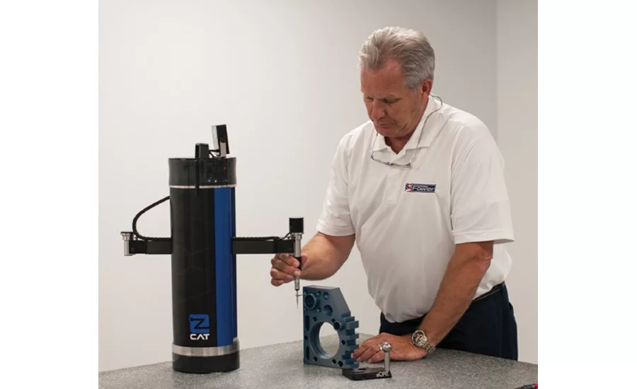

Portable CMM measure the surface geometry of parts. They typically use a measuring arm, also called an articulating arm, which collects a measurement point, or a 3D coordinate, with each point of contact.
Portable CMMs support the computer-aided inspection of manufactured parts by taking measurements and comparing them to CAD models, to decide if the part meets quality standards.
Traditional CMMs are highly accurate, but they are cumbersome, can’t be moved easily, and require controlled environments.
Portable CMMs are a more flexible, less expensive alternative.
Operators can relocate portable CMMs to the shop floor. These lightweight machines do not require controlled environments, either.
They can capture 3D measurements from different categories of parts, and while traditional CMMs are used only for quality inspection, portable CMMs can be used for other applications including reverse engineering, rapid prototyping, and scientific research.
