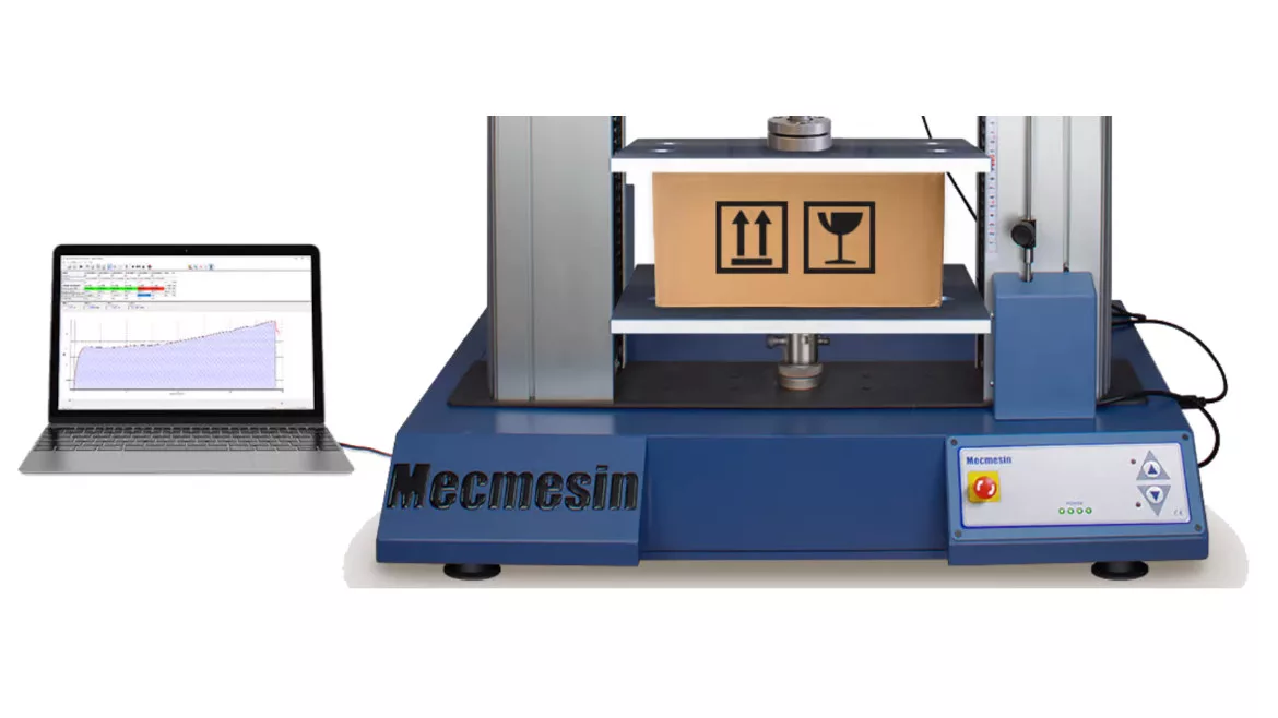

The business advantages of top-load testing are already clear, but the choice of test system can be a challenge. Testing standards stipulate top-loading should be applied under controlled conditions at a fixed speed, so this requires a motor-driven test system not a manual tester.
If the tester is located in a production area where the use of a PC is not ideal, it is often better to use a touchscreen-driven top-load tester. If more complex test routines in the QC or R&D labs are required, then a PC-driven tester is preferable.

To perform a top-load test, a bottle, taken from a batch at regular intervals from each production line, is placed on the base of the test stand. The test method is selected using the five icons on the touchscreen’s console. When the ‘start’ button on the touch screen is pressed, the crosshead descends at a fixed speed. When the top of the sample is reached, a touch is registered, the free height of the bottle is captured, and compression begins. Load is applied until deformation is detected, at which point the maximum force (top-load strength) is captured.
The results of the test appear on the touch screen in tabular or graphic format, peak load and free height is recorded, and a color-coded “pass” or “fail” result is reported. When the test finishes, the crosshead returns to its home position, ready for the next test. Results can be stored internally, on the touch screen’s hard drive, or exported to a statistical process control (SPC) or other quality monitoring systems.
QM 0422 NDT Back2Basics Graph
Computer-controlled systems are the superior option for advanced test measurement. Fully programmable, these systems are operated from a computer running software. Test results are displayed graphically in real-time and enable automatic calculations to be performed on top-load test parameters. Image source: PPT Group (Click on the image to enlarge.)
