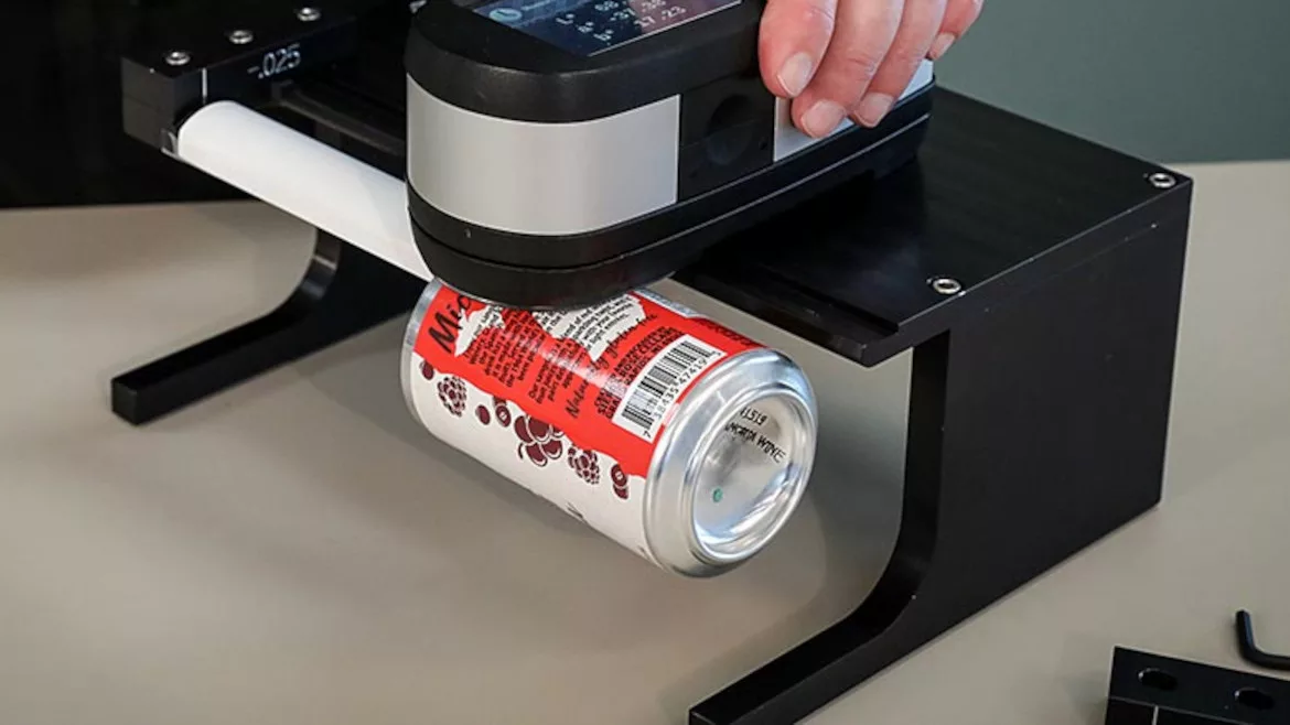

  4. Are you using the right color measurement device, and is it set up correctly? Spectrophotometers are used in most quality control processes to verify that color is within required tolerances. These color measurement instruments vary in size, geometry, functionality, and accuracy. Using the wrong device for your color measurement application can lead to inaccurate color. You should also use the same or a similar measurement device as specified in the digital standard, and ensure the device is set up using the same measurement conditions to capture similar spectral data. If you are not sure what type of spectrophotometer is best for your application or do not know which measurement conditions to use, talk with your customer or consult with an application specialist from the device manufacturer.
    QM 1022 Measurement can cylinder fixture 0051
    X-Rite Cup and Cylinder Fixture with the eXact spectrophotometer
    If your sample is extremely large or small, liquid or powder, or an odd shape like a cylinder, a spectrophotometer accessory like an adjustable stand or sample holder can help. These accessories ensure the sample is held and positioned correctly for each measurement without damaging the device or sample, which can introduce errors into your process. By using the right device, accessories, and measurement conditions, you can truly compare “apples to apples.”
