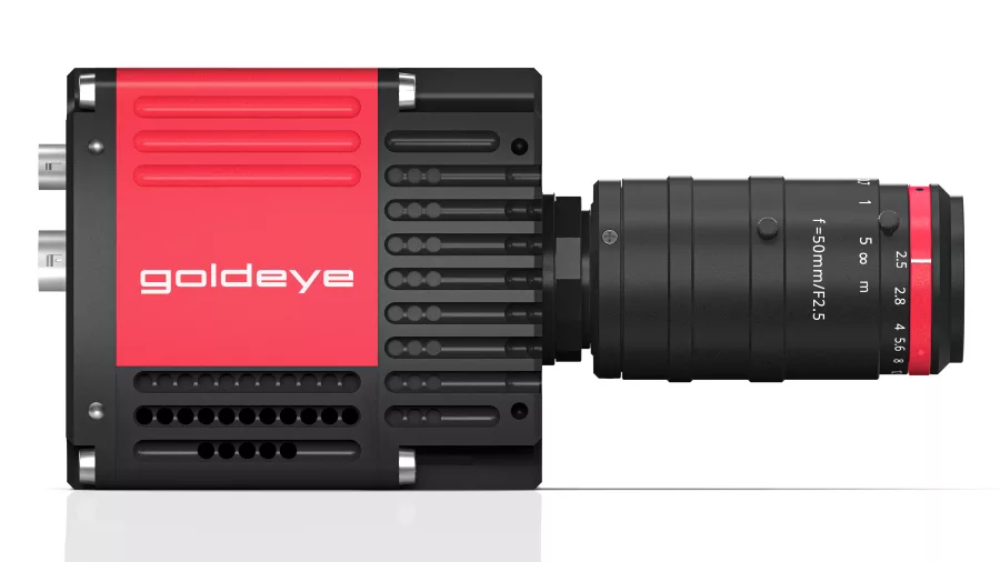

Allied Vision is launching four new Goldeye SWIR camera models equipped with extended range InGaAs sensors, which can detect wavelengths up to 1.9 μm or 2.2 μm at high quantum efficiencies. The integrated dual-stage sensor cooling (TEC2) and several on-board image correction features are key factors to make specific spectral features visible with outstanding image quality.
Goldeye XSWIR cameras reveal  material properties in the wavelength range above 1.7 μm. By sensing further into the infrared range, more unique spectral features can be detected to better distinguish between different materials. This is especially important for sorting applications or to determine material concentrations in composites. Main application fields are, for example: Waste recycling, water content (moisture) detection, identification of foreign objects or contaminations, and laser beam profiling. With the new Goldeye XSWIR models, Allied Vision’s famous Goldeye camera series now covers the wavelength range from 0.4 μm (Goldeye VSWIR) to 2.2 μm (Goldeye XSWIR).
The Goldeye G/CL-034 XSWIR features lnGaAs focal plane arrays with 15 µm pixel size that are either sensitive in the wavelength range from 1.1 μm to 1.9 μm or 1.2 µm to 2.2 µm. At VGA resolution (636 x 508 pixels), these cameras achieve 303 frames per second. The same spectral ranges are supported by the Goldeye G/CL-008 XSWIR models incorporating a focal plane array with QVGA resolution at 30 µm pixel size that can be operated up to 344 fps at full resolution (320 x 256 pixels).
All models will be provided with GigE Vision (G) or Camera Link (CL) interface. First evaluation test samples with GigE interface are available.
