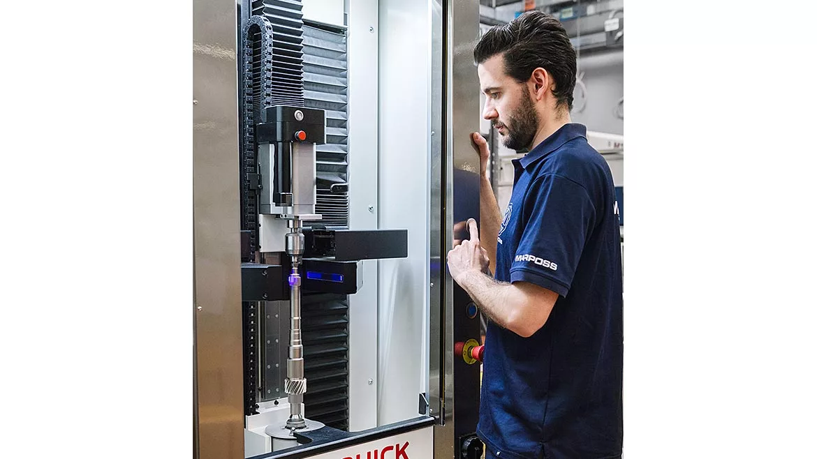

QM 0323 Measurement G25-2
Optical scanning solutions offer noncontact optical scanning for rapid and accurate measurement and systems like this one can be combined with touch probes for inspecting for non-visible features.
