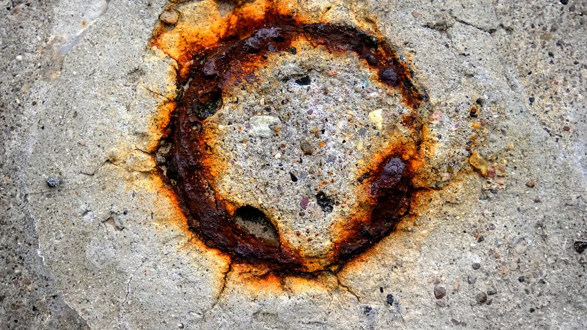

The oil and gas industry continues to face the costly and challenging problem of detecting corrosion under insulation (CUI) or under fireproofing (CUF). If left unchecked, the consequence can be dire; the corrosion may cause a failure and even lead to a partial shutdown for safety issues it could potentially create. Data shows CUI as the leading cause of pipe leaks in past years1. Refinery operators must inspect their assets for corrosion as stated in the API 5832 standard. The usual workflow involves screening general areas where corrosion is suspected to be a critical problem, locally stripping the asset, and then using ultrasonic testing to measure the remaining thickness precisely. The problem resides in assessing the whole asset efficiently. In addition, stripping and reinstalling the insulation is not only expensive but also very time-consuming. Over the past two decades, many alternative inspection methods have been used to tackle this challenge. The one that became recently popular for its outstanding results? Pulsed Eddy Current, or PEC.
