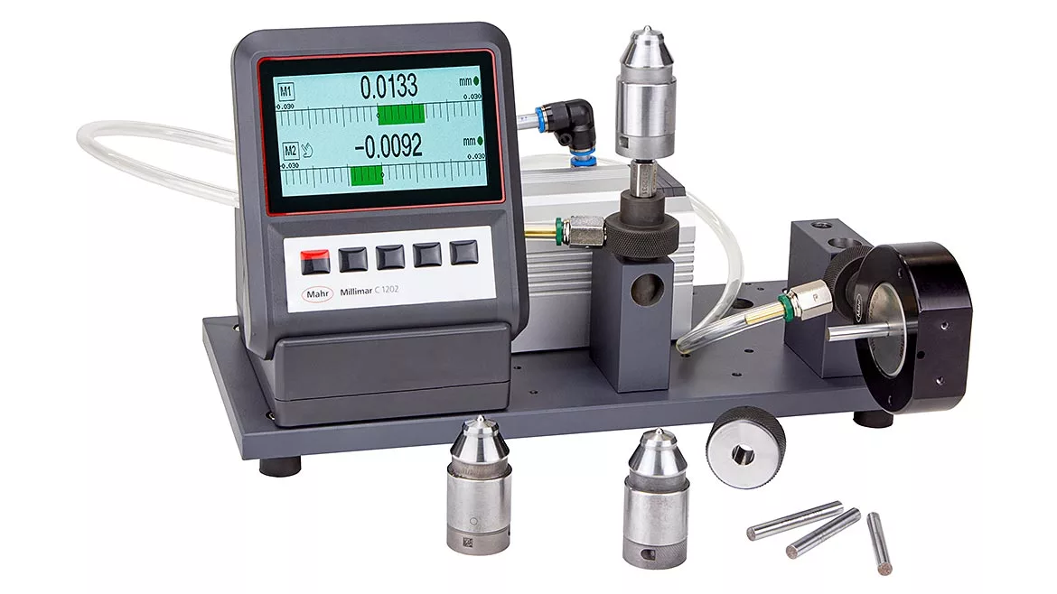

Materials And Coatings
Air tooling is designed for use on the shop floor in some of the harshest manufacturing environments, often measuring countless numbers of IDs, ODs, and lengths over the life of the part manufacturing cycle. Air gaging is also used for measuring pump barrel rods or in automatic gaging operations where millions of cycles are common.
Air tooling was initially manufactured from hardened tool steel. This offered acceptable life, and rust would not be an issue if used with residual oils from the shop floor. But store that plug for a few months, especially in a humid climate, and the chances of pulling it from storage showing signs of rusting would be typical.
Enter chroming the tool. Chroming became a popular and widely accepted method for two reasons. First, chroming helped to prevent rust and was often required when the tooling was going to a hot and humid region. Second, chroming dramatically increased the wear characteristics of the tooling.
While these are great features for the user, in today’s world, it is not a great option for the manufacturer or the environment. In addition, chroming is becoming expensive to control, and many towns and states will soon likely ban chroming operations completely.
In its place are two advances that solve these issues and often provide shorter lead times and improved products. The first is manufacturing the tooling from hardened high chrome content stainless steel. The high chrome content stainless approaches the same characteristics of chromed tooling. It helps to prevent rust while providing long life for the plug.
04 QM 0823 Measurement Plugs
Also, as an alternative to chroming, tool life can be extended with a new, physical vapor deposition AlCrN-based coating that offers superior wear characteristics, ideal for improving the life performance of air tooling in production environments. This vapor disposition is like the coatings offered on machine tool cutting bits for an improved life. The new coating replaces the environmentally harmful chrome plating previously used for high-wear applications. It provides excellent hardness and shock resistance.
These coatings also offer a rich dark grey color that distinguishes the new plug in appearance. Even in high humidity, it enables superb wear and rust prevention results. This coating option offers the user of air tooling far superior longevity for high-usage applications.

It’s An Analog World—Well, Maybe Not For Long
Air gaging was introduced long before digital displays. The original display consisted of water levels in glass tubes, a bobbin floating in a tapered glass tube, or some form of a mechanical-based analog dial. Most air gaging is still based on the magnification derived from the actual length of the analog dial compared to the movement seen by the air tool. Thus, the typical magnification referred to on a lot of air tooling, such as 2500:1 or 5000:1, for example, comes from the analog dial’s length.
  • Air Gaging Basics: The 4 W’s
  • Air Gaging in a High Production, Automated Manufacturing Environment
Why the different magnifications? Well, again, it comes from the characteristics of analog readouts. With analog dials, you can have “long range and low resolution” or “short range and high resolution.” This characteristic matched nicely with part tolerance—as the tolerance gets smaller (less range), one typically would want higher resolution (higher magnification). As with dial indicators, the goal is to have the tolerance be approximately 20% of the dial, and magnification was chosen based on this.
Today, measuring displays are increasingly going digital for many reasons. First, more users require data collection for quality and process monitoring. One can get more powerful measuring systems through digital-dynamic functions, actual part sizes, and automated processing. Also, most analog display systems are based on mechanical or electronic meter movement. Since these meter movements are becoming either costly to manufacture or harder to find, these types of readouts are in the final stage of their product life. Third, digital-based sensors can offer long-range and high resolution in one unit, so it is not necessary to match displays with tooling for proper use. Instead, the tooling measuring range determines the measuring capability and not the display. And finally, digital displays do not have the range/resolution issues of an analog dial; digital readouts provide both long range and high resolution.
06 QM 0823 Measurement Screenshot
Thus, most air tooling is built around designing the best clearance between the air tool and the part based on the tolerance and the size of the part measured to minimize centralization errors, especially for smaller diameters. Therefore, the display will function with long or short-range tooling while presenting a high-resolution digital value.
One of the latest breakthroughs in digital readouts is that the displays are becoming as high resolution as some of the best TVs today with similar refresh rates. In the past, displays have tried to simulate an analog display, but often the results were marginal, with LEDs skipping while trying to keep up with the reading. But with today’s display capabilities, an analog simulation is just as sharp and crisp as an analog meter.
Configuring For Changing Requirements
Many of the air gage readouts that have been available for decades were single-use, dedicated to the tooling systems. This could be a good thing at times because it was simple; users would get used to their operation and easily multiply through the workshop. However, on the downside, if that job requirement disappeared, the display, while still functional, had no use until a similar application came along.
As with the tooling and improvements, changes in performance and added value are also seen in readout systems. With the new and high-volume production of electronics, one can purchase next-generation displays for less cost than mechanical meters being manufactured now. This provides an added incentive to move to digital displays.
07 QM 0823 Measurement C1202
Additionally, digital bench amplifiers for air systems are no longer dedicated to air. Instead, more systems are designed to have a modern, powerful, full-featured display “base unit.” This allows the user to configure the base unit with the type of input needed for the application, whether air, LVDT, or digital probe. As previously noted, since air tooling has not changed much in the past 80 years, it is possible to make significant digital display updates at prices less than the old system may have been purchased for. The value comes from better performance, features that simplify the part classification for the user, and built-in data-sharing capabilities for process monitoring.
However, upgrading is not limited to the same manufacturer tooling. Since we know air tooling works on the same laws of physics, all manufacturers’ tooling is very similar. Therefore, the potential exists to get a readout upgrade for the user. And since these digital systems have much more capabilities, it is simple to move from single- or dual-master step up with the same system, again, based on the similarities of all manufacturers’ tooling.
But another option for these newer modular systems with universal bases is that they can be made an air gage system for one application. Then, if that job goes away, it can be turned into an electronic LVDT-based display by reconfiguration.
