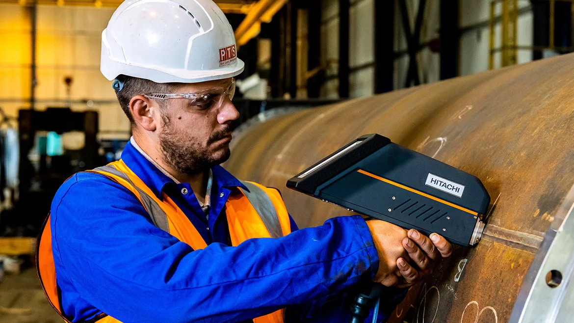

Portable optical emissions spectrometers allow users to reach key areas of the plant for measurement. Source: Hitachi High-Tech
