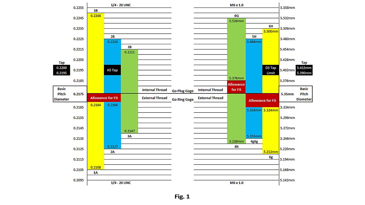

If the customer decided to use a gage based on the Tap tolerance, typically - 0.0005”, 0.2195” Go / 0.2220” No-Go (Fig. 1), the customer would receive a gage where any two or more operators inspecting the threads could have both the Go and No-Go fit. For this reason, we do not make a Go /No-Go thread plug gage that has a less than 0.0012” separation between the Go and the No-Go pitch diameter. This gage would not be functional and would not give the user a fair pass / fail inspection of the product thread. The other problem is if the customer was able to use the gage, any part smaller than 0.2195” would fail the 0.2195” Go thread plug PD. All product threads in the pitch diameter range of 0.2175” to 0.2194” would be scrap but, according to ASME B1.1, would be in tolerance.
To help us better understand the reasons gages should not be made to tap specifications, let’s take a look at the taps and gages for a standard ¼-20 UNC 2B internal thread. In the (Fig. 1) chart, you will see a graphical example of the various tolerance bands based on the Thread Class for both a Unified Inch Screw Thread and the M Series Metric Screw Thread. The ¼-20 UNC thread data and various Classes are shown on the left. The minimum Pitch Diameter or Basic Pitch Diameter is the starting point for the product, taps and gages. Internal threads are built based on a premise of the Basic PD + the Tolerance Class for both the product and the gage specifications. Taps are designed and have a tolerance based on a deviation above the “Basic” or minimum pitch diameter of the internal product thread. Taps for Unified Inch screw threads have “H” Limits that dictate the pitch diameter of the tap. Each “H” value equals 0.0005” added to the Basic pitch diameter.
QM 1223 FEAT Test Fig 1 H5 (STD) Tap Gage 8 21 23

Cutting a ¼-20 UNC 2B internal thread with a Basic PD = 0.2175”,the generally suggested tap “H” limit to create a Class 2B thread is an “H5” tap limit.
Example:
H5 Tap Limit = Basic PD + (0.0005”x 5)
H5 Tap PD = 0.2175” + 0.0025” = 0.2200”
This means that the Tap will create an internal thread pitch diameter of 0.2200” or larger. As you can see the 0.2200” Tap PD is smaller than the maximum product and No-Go plug gage pitch diameter of 0.2224”. In this case there is a 0.0024” clearance below the top of the product pitch diameter tolerance. This clearance will allow for some other machining issues from the tapping operation. The issues may be run-out in the tap, the tapping head or the material being tapped. As long as the internal thread pitch diameter is larger than the “Basic” (minimum) pitch diameter 0.2175”, the GO thread plug gage should pass the full threaded length of the internal thread.
       If the product manufacturer decides to use a larger tap to manufacture this thread, they may not need to order a special gage, until the pitch diameter of the tap exceeds the max part and No-Go pitch diameter of 0.2224”. This would roughly equal up to an “H9” tap limit at a pitch diameter of, 0.2175” + (0.0005” x 9) = 0.2220”, (Fig. 2). When the special oversize thread causes the manufacturer to use a tap pitch diameter larger than the maximum product pitch diameter is when things get more challenging.
