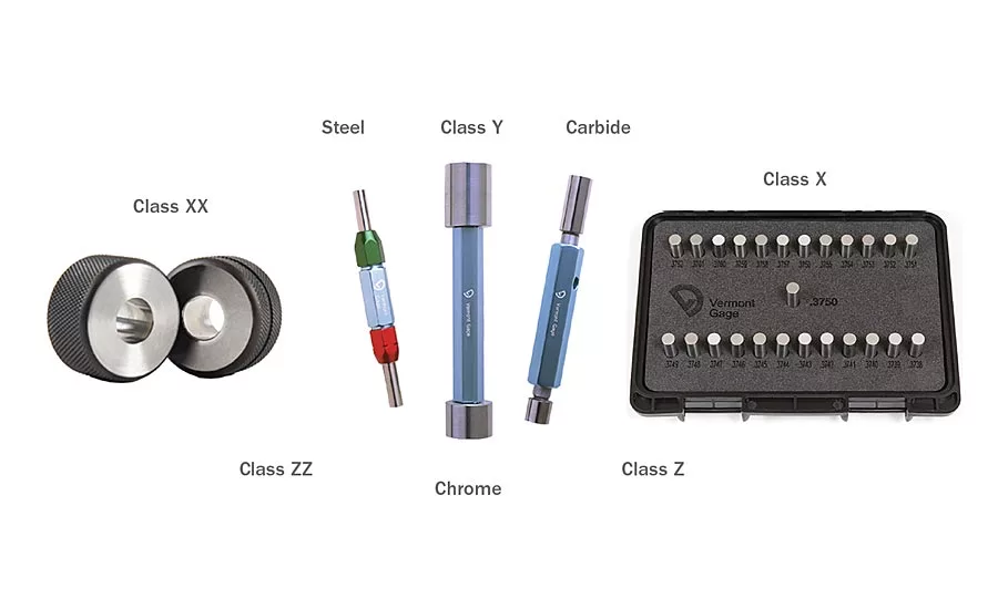

Within the measurement plan are decision rules. These decision rules help us to select the best measurement tool based on the product design, material, industry standard, dimensions and tolerances. The product tolerances dictate the gage tolerances. The gages never dictate the product tolerances. The gages and measuring tools must have an accuracy that is less than the product tolerance by some factor. Guard bands represent these factors. The guard bands protect the extremes of the product tolerance. In the example in Figure 1, the internal diameter is .250” - .254” (.250 +.004”).
Using the 10% Rule as our guide or starting point, the decision rule is binary; only two possible outcomes: pass or fail. Binary rules are typical for go / no-go fixed limit gages. In the Figure 1 example, the product tolerance is .004”. The calculation (.004 x 10% = .0004”), the total tolerance the gages may use is .0004”. This tolerance is split (.0004” / 2 = .0002”). One half applied to the min and max product diameters. The suggested gage tolerance would be .0002”. This equates to a Class ZZ gage tolerance per ASME B89.1.5 (Fig. 2) for this diameter range. The suggested gage would be .2500” + / .2540” – Class ZZ go / no-go plug gage assembly. This example works for suggesting a fixed limit plug gage.
Let us assume the part has an internal diameter of 4.780” +.040” tolerance (4.780” / 4.820”). In this case, you could use a 4.780” / 4.820” Class ZZ Trilock go / no-go plug assembly. You could also use and ID micrometer or a bore gage that has a 10:1 or better accuracy (+/- .002” accuracy). The decision comes down to a couple of factors. If you need an actual measured value, a variable gage would be the best choice. (As long as the variable gage meets our +/-.002” accuracy.) If pass / fail is all that is required, the go / no-go plug gage will work. Cost and availability are also considerations. There are a number of other questions to consider. If the gage we have in house has the required accuracy, is available and recently calibrated, we use the in-house gage.
Parts with a tighter tolerance can be more challenging. Using the example of a part with .250” +.0005” internal diameter, the guard band (gage tolerance) calculation and the inspection become more difficult. Using the 10% Rule, the product tolerance is .0005”. Ten percent of the product tolerance is .000050”. The binary min and max tolerance = .000025”. Using 10:1 a .2500” + / .2505” - Class XX (.000020”) go / no-go plug gage would be used to inspect this internal diameter. How frequently will we have to calibrate / replace the go gage? Should the go gage be carbide to prevent wear? Do we need to use the 10:1 rule or should we use 4:1 or some other ratio? Many of these decisions come down the accuracy of the measuring device and the amount of the product tolerance we can surrender to the measuring tools and the material of the product inspected. (The 4:1 rule usually comes into play in lab environments for the calibration of the measuring tools.)
If surrendering 25% (4:1) or 10% (10:1) of the product tolerance to the measuring device is not practical, the use of incremental plug gages, or a combination of both fixed limit and variable gages may be used. In the previous example, we could use three Class X Go pin gages to creep up to the minimum internal diameter size and the calculated no-go gage. The three go plug gages could be .2498”, .2499” and .2500”. All three gages would have a +.000040” tolerance. This allows us to account for some of the allowance for fit between the gage and the part. This will not give us an exact value for the low side of the hole. It does reduce the possible variations. If the .2498” & .2499” both fit and the .2500” does not or is snug, it would indicate the hole is between the .2499 and the .2500 diameters. Force, surface finish and part geometry will affect the accuracy of this option. (Never force a gage.)  In measuring shafts, many customers will use a fixed limit go ring gage to represent the max material condition and hand micrometers to check for min material condition.
gage tolerance
Figure 2. The suggested gage tolerance would be .0002”. This equates to a Class ZZ gage tolerance per ASME B89.1.5 for this diameter range.
