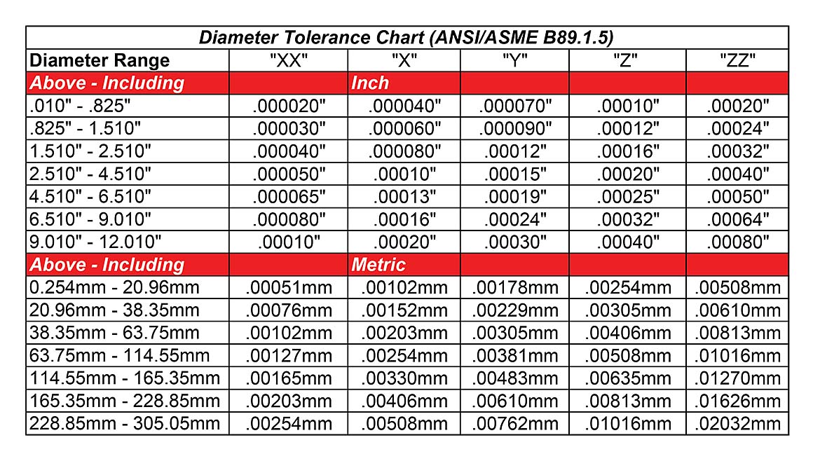

There is a general belief that if a tool has a digital readout, it must be more accurate. While resolution of the measuring device is important, more decimal places do not equate to a more accurate gage. For example, in the opening image you will see a Fixed Limit Tri-lock Go / No-Go plug gage and a digital bore gage (with three contact points at 120°). Based on this picture we cannot determine which is the more accurate inspection tool. The Go / No-Go gage is not marked with a Tolerance Class. The Bore gage shows a 5-place decimal on the amp. Below is a list of the tolerances available for the Fixed Limit plug gage.
Diameter Tolerance Chart (ANSI/ASME B89.1.5)
Source: Vermont Gage
If the Fixed Limit 2.310” – 2.311” Go / No-Go Tri-Lock gage shown is a Class XX and falls within the diameter range of 1.510” – 2.510” and has a Class XX tolerance, the gages will have a unilateral tolerance of 0.000040”. The Go has a +0.000040” tolerance and the No-Go have a -0.000040” tolerance. The Tri-lock Fixed Limit gage provides a Functional inspection of the product internal diameter. The Bore gage shown has an accuracy of 0.000060” (+/- 0.000060” or a potential total measurement variance of 0.000120”) depending on the actual ID being measured. In this case the Tri-Lock would be the better choice based on the gage accuracy and functional inspection.
Gage accuracy is only the starting point. Using the Class XX Tri-lock gage requires less training to use the gage effectively. The Go fits and the No-Go does not the inspector passes the part. The cost of the Class XX Tri-lock gage is less than the cost of the Bore Gage. Sounds like the Class XX Tri-lock Plug gage is the best choice. Not so fast. While the above statements are correct, the Variable gage has advantages as well. If the product tolerance drives a Class Y (0.00012”) required gage tolerance, for the Tri-lock Fixed Limit plug gage, the Bore gage would be more accurate than the Tri-Lock Plug gage. (Yes, you may order a Class X or XX gage and use a closer tolerance Fixed Limit gage). The Bore gage has other advantages. The Bore gage head can measure a range of diameters, 1.970” (50mm) – 2.360” (60mm), for our example. You may purchase additional heads for different diameters. The Tri-lock Plug gage only inspects the diameters specified as Go and No-Go diameters. If your measurements require recorded actual measured values (not functional), or SPC data, and the accuracy of the Bore Mic and the Fixed Limit Gage are the same, the Bore Mic is your best option.
