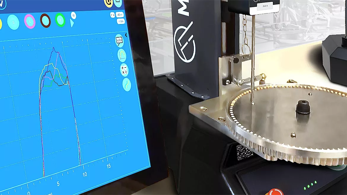

The single pellet crush test can be time-consuming when there is the essential need to calculate representative data for a whole batch. A software-controlled materials tester augmented with a degree of automation can vastly increase repeatability, throughput and confidence in the recorded hardness data.
PPT Group. Pellet auto tester single frame closeup
An automated pellet crush testing system. Many individual pellets are loaded at one time onto a rotating platen, into which has been machined suitably dimensioned depressions to locate each single specimen. Operators are spared the repetitive error-susceptible (and tiresome) task of manually loading the sample to perform an individual material crush resistance test.
Software is an integral part of a modern materials testing system, controlling the mechanical movement of the fixtures to apply appropriate loading to the test piece in tension or compression. It also enables the repetition of tests from which a representative hardness (kg/granule) for the supply is easily and reliably obtained. The software performs extensive statistical analysis of results across sample batches and can present data in easily digestible report formats.
