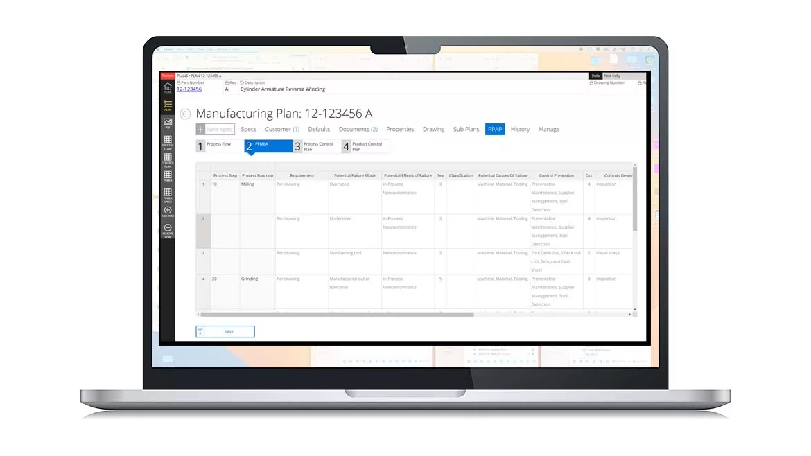

FMEA, Part 2 Screen shot of Manufacturing Plan on laptop
Image Source: 1Factory

Matt Stanley, the director of customer at 1factory, discusses the need for an evolution in customer expectations regarding FMEA. He points out that “PFMEA [Process Failure Mode and Effects Analysis] is a valuable tool, but not every job is equal.” He notes the diverse expectations from different companies, with some focusing on reducing the Risk Priority Number (RPN) beyond a certain threshold, while others focus on actions for the top percentage of RPNs. Stanley emphasizes the need for scaling RPN expectations with the complexity and type of part. He cautions against applying a broad scope to all parts, especially for low volume/low-cost orders, which may not fit well into the Production Part Approval Process (PPAP) framework.
Technology’s influence on FMEA
Discussing the impact of technology on FMEA, Stanley emphasizes the importance of quality software. “Without properly tracked and documented data, you’re chasing the current hot topic and often missing the underlying problems when trying to improve your process,” he says. “Quality software and AI initiatives help to show the bigger picture and provide hard data that can steer your attention to recurring issues, as well as justify the effectiveness of implemented solutions.”
Diane Tilley, senior vice president at SigmaXL, mentions the ease that technology brings to FMEA. “The FMEA template in SigmaXL makes it easy to create your FMEA with a ‘sort’ button for RPN scores.” Arthur also suggests a future role for AI, asking it: ‘How could this process fail?’ ‘How could we prevent it?’
