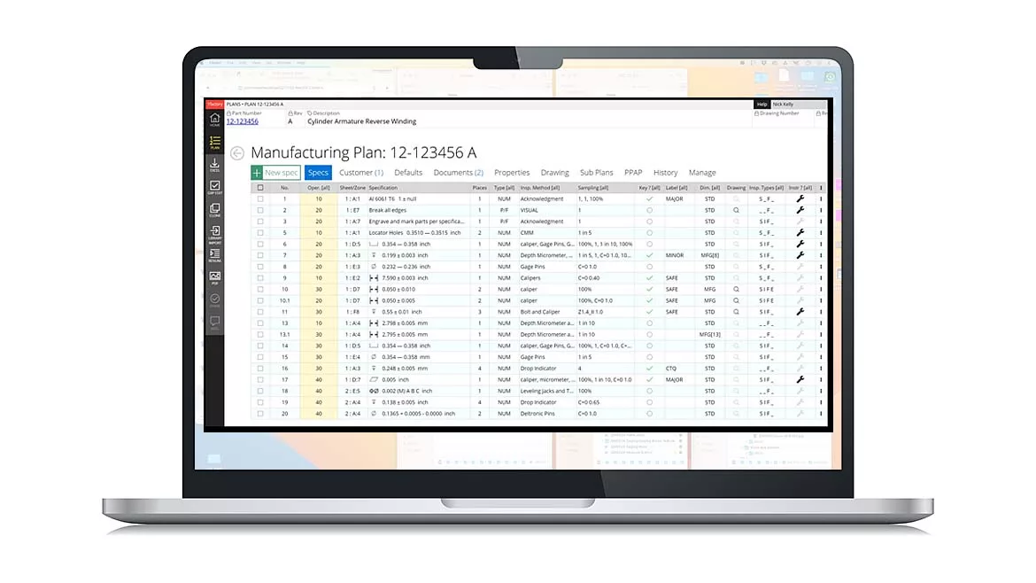

FMEA Correlating Inspection Plan shown on a laptop screen.
Image Source: 1Factory
