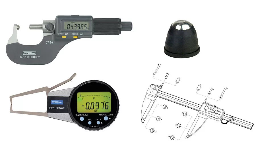

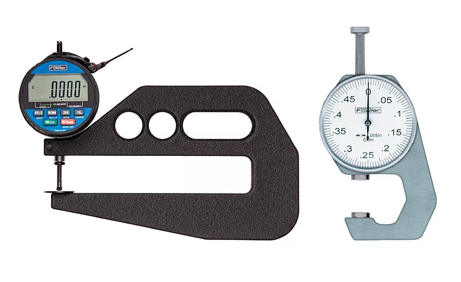

On the surface, thickness seems like an easy measurement to take, as dimensional measurements go. You have two big, flat, parallel planes on which to plant your gage. For hard materials, like metal sheet, you can use three of the four measuring capabilities of a slide caliper. A micrometer does very nicely, too, if you have the time and need the accuracy. If the need is constant, then speed becomes a consideration. In this case, dedicated thickness gages exist, which are fast, simple, and spring-loaded to make the measuring force repeatable.
What if the material is irregular?
Non-flat materials can be checked with much the same methods. All this requires is a spherical or conical contact point for your gage. Dedicated gages are available, as are add-ons for most common gages.

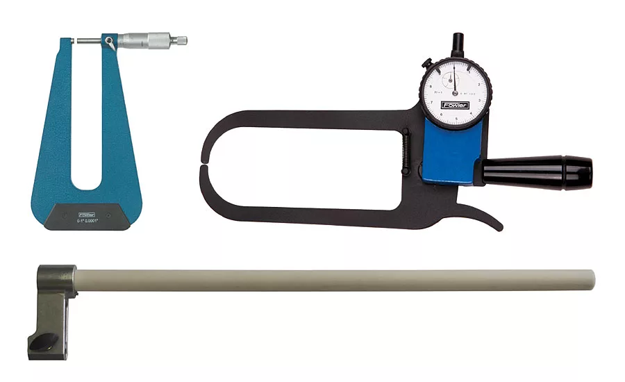

What if we need to take a measurement in the middle of a sheet?
This is a little tougher. Specialty deep frame micrometers and external caliper gages exist which can reach much farther onto a thin workpiece than standard tools allow. Sometimes, a drop indicator is employed with a long reach holder to do the job. More sophisticated applications may use a separate indicator up through the table and use a differential reading to eliminate error from bowing of the material. A height gage with long reach attachments may also be a good solution.
How about a tube wall?
This is a little trickier. You can use a micrometer with a ball anvil on the inside. There are specialty micrometers which use a pin for the fixed contact to allow access into very small tubes. External caliper gages also exist for this purpose. In each case, the inside contact must be rounded more sharply than the tube, to ensure a single point of contact for the measurement.
What if the material is soft or flexible?
For this type of application it is critical to ensure that your measuring pressure is correct and repeatable. Your baseline thickness reading won’t match any subsequent readings if the material is deforming differently each time. Measuring pressure is a function of two things: the force and the area.
For measurements of this type, a drop indicator in a measuring stand is the way to go.
The force is set and very repeatable. If an extra light touch or linearity is required, the spring can be removed and weights used to provide the force. Weights can be mounted to the top of the slide in place of the lifting handle.
The area can be adjusted by way of the contact point. Innumerable flat and spherical contact points of all sizes and shapes are available. The only catch is to know whether your contact point uses inch (4-48) or metric (M2.5) thread. There are only these two common options.
