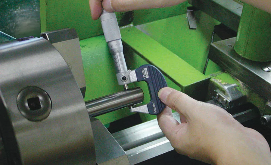

Outside micrometers
The most common micrometer, an outside micrometer, is used to measure outer dimensions that are round or rectangular, as well as other shapes. Common measurements include shaft diameters and sheet metal. Standard micrometers with flat anvil and spindle faces are limited to measuring workpieces that are equally flat, parallel or cylindrical. While most people are familiar with outside micrometers, a variety of special purpose micrometers are available to address the needs standard micrometers cannot.

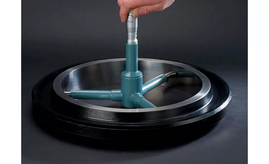

Inside micrometers
Inside micrometers measure the inside dimension of an object such as tubing or a cylinder. Like outside micrometers, inside micrometers are also available in application-specific types. They are classified as tubular inside micrometers, caliper-type inside micrometers and three-point type inside micrometers.
Tubular inside micrometers are available in several types: single rod, extension type, interchangeable rod, interchangeable tip and internal gear measuring. The single rod is the most widely used inside micrometer. Tube micrometers are designed to measure wall thickness of tubular parts, such as sleeves and collars. They also can be used for measuring from the inside of holes that are too small for the anvil end of a standard micrometer to be inserted.
Tubular inside measurements take a comparatively long time for making measurements. The longer handling time increases the effect of heat on the micrometers which can substantially increase its length, resulting in a minus error. To minimize the thermal effects, the inspector should always wear gloves and try to minimize measuring time.
Caliper-type micrometers require more skill to use because the micrometer must be accurately aligned with the diametral line of the hole being measured. To measure hole diameters, the jaws are inserted into the space to be measured and are adjusted using the ratchet.
The three-point inside micrometer is simpler to use than a caliper micrometer because it aligns itself with the hole axis by means of three evenly spaced anvils. This allows accurate measurements to easily be made without any special skills. It uses a tapered part, either a cone or thread, for converting the spindle’s axial displacement to the radial displacements of the contact points.

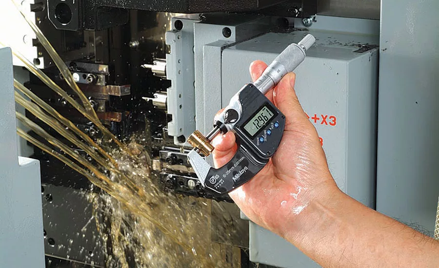

Adding to their durability and longevity, coolant-proof micrometers are free from measurement error and physical deterioration due to routine exposure to water, cutting oil or coolant. This high performance is achieved by using encoders that are inherently immune to contamination, where exposure is inevitable, combined with comprehensive sealing techniques and extremely oil-resistant materials to guarantee a long working life under normal operating conditions.

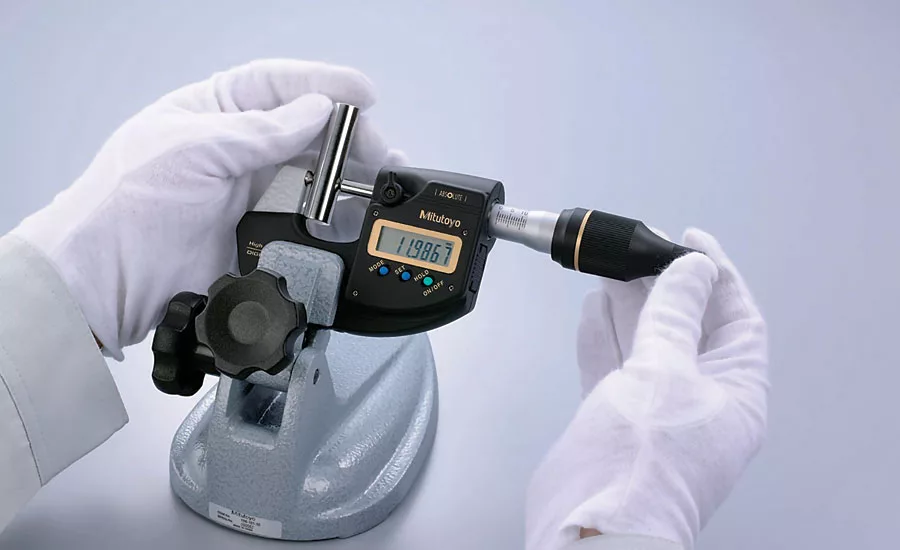

Moving forward, the industry is starting to see an increase of submicron resolution micrometers for those who need to make highly accurate measurements with a handheld tool. Contributing to the high resolution is a rigid frame, as well as a heat shield that minimizes errors caused by thermal expansion. In addition, newer models have an absolute rotary sensor that eliminates the need to perform an origin setting every time the micrometer is turned on, allowing the operator to start measuring right away.
