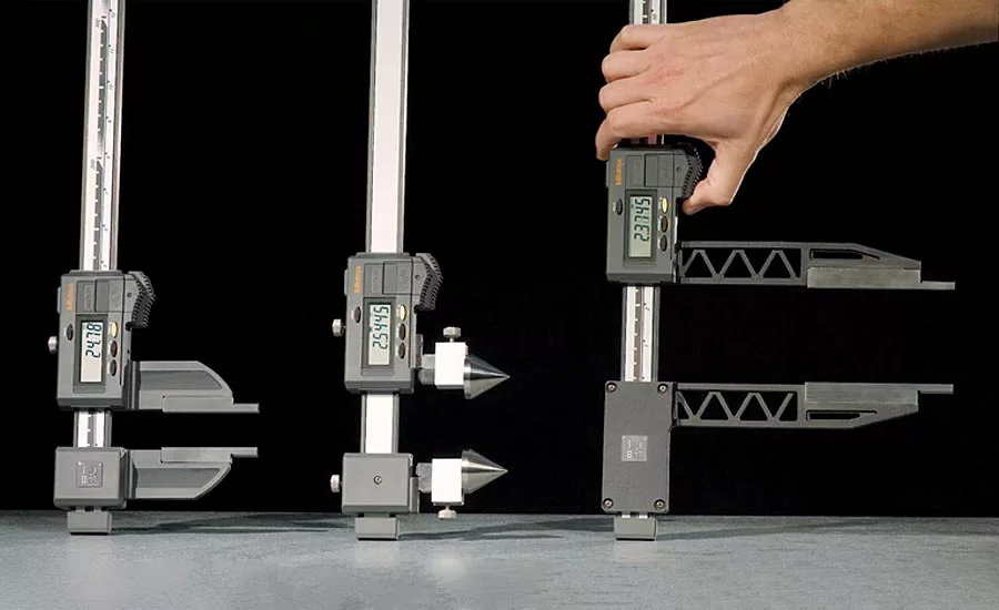

carbon fiber calipers
Example of Carbon Fiber Calipers. Carbon Fiber calipers are a lightweight alternative ideal for large, long-range calipers. Source: Mitutoyo America Corporation

  3. Carbon Fiber calipers, which are a lightweight alternative ideal for large, long-range calipers.

While stainless steel remains the industry standard, there are some instances where other materials could be a better fit. For instance, if you’re in need of a larger caliper but also one that is lightweight, ergonomic, and easier to handle, a carbon fiber caliper is an ideal choice.
It’s important to keep in mind that there are also different types of jaws for the different types of calipers. For example, there are extended jaws for stainless steel and carbon fiber calipers, which give you more reach to measure larger diameters or components in general. There is also a nib-style jaw, which is less likely to get bent, dented, or dinged at the tips compared to a standard style jaw. Nib-style jaws are also thicker and wider, and a better fit for measuring inside diameters due to their rounded nature.
It’s also good to keep inserts in mind. While the standard for carbon fiber inserts is generally stainless steel, ceramic inserts are also available. Ceramic inserts tend to have better wear resistance, so if operators are rough with the calipers, they won’t be damaged versus using stainless steel that can be dinged. That’s because a ding on a stainless-steel caliper tends to flow the material up, resulting in an irregular surface that can impact accuracy. Ceramic, on the other hand, merely chips out when dinged, preventing material flow that could result in a false surface reading.
