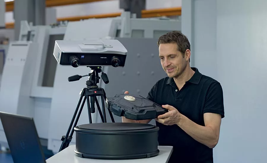

ZEISS COMET L3D 2 measures contour by triangulation between the single camera and the projector. Source: ZEISS

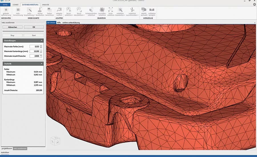

Quick triangle mesh generation using high-quality data reduction. Source: ZEISS

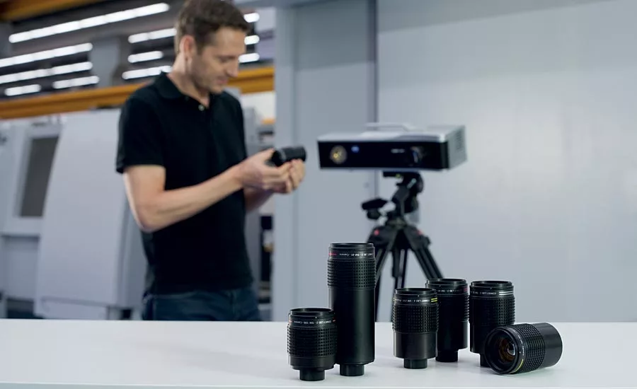

Cameras and projectors use interchangeable lenses to cover a range of different-size fields of view. Source: ZEISS

Blue light technology recognizes contour by triangulating the line of sight of a photographic lens and the line of sight of a light source that projects a “fringe” pattern onto the surface being measured and then uses software to convert multiple images into a three dimensional representation. This is essentially a photographic process that, depending on the vendor, involves a fringe pattern projector and either one or two cameras. In either case, the object being scanned is turned using a high-precision rotary table to allow a full 360° representation. In some cases, after being scanned through a full 360°, the object is turned and then scanned through the full rotation again to achieve a spherical, rather than just cylindrical, view.
Single vs. Multiple Cameras
The problem with multiple cameras is that their view is only effective where their respective fields of view overlap. For this reason two cameras can actually provide a narrower field of view than a single camera does. If the purpose of two cameras is to provide triangulation to measure contour, that function is served in a single-camera design by triangulation between the single camera and the projector. And because two cameras have slightly different views of the subject, the resulting measurement can potentially be less sharp than the single WYSIWYG image produced by a single camera.
Cameras and projectors use interchangeable lenses to cover a range of different-size fields of view. This allows inspection of anything from a very small part to an entire vehicle. When lenses are changed, and in other cases as well, the camera must be recalibrated to ensure maximum precision. For obvious reasons, lens change and recalibration are simpler processes in a single camera setup than when dual cameras are used.

The blue light scanner’s software combines multiple scanned images into a 3D surface image that can be stored, rotated, expanded, and otherwise examined to evaluate a part or assembly. The software creates a “point cloud,” a cluster of points representing the scanned object. The camera and field of view determine the density of points, essentially pixels representing the virtual object. The software algorithm eliminates overlaps among the individual images to create one seamless data set in the STL (stereo lithography) format. STL files can be used for inspection and quality control, tool and model making, reverse engineering, rapid manufacturing and more.
The challenge for the software is recognizing the points of overlap among the multiple images. In some systems this is achieved by attaching visible “targets” to the item being scanned in much the same way that a cinematic “motion capture” system places visible targets on an actor in front of a green screen and then process the video image to create a character in a setting following the actor’s movements.
In the same way, the optical scanner’s software matches the targets in adjoining images to position the component images into the complete final image. Attaching and removing targets takes time, and they must be properly positioned to ensure that all of the images can be integrated into the final image. The alternative approach is to use software that can recognize features of the scanned object itself, defining those as its targets, and using them to align the individual images. This method requires somewhat more sophisticated software, but it simplifies the scanning process and ensures maximum accuracy.
