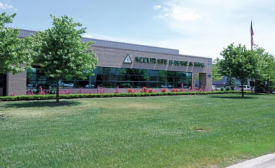

Accurate Gauge & Manufacturing (Rochester Hills, MI).
