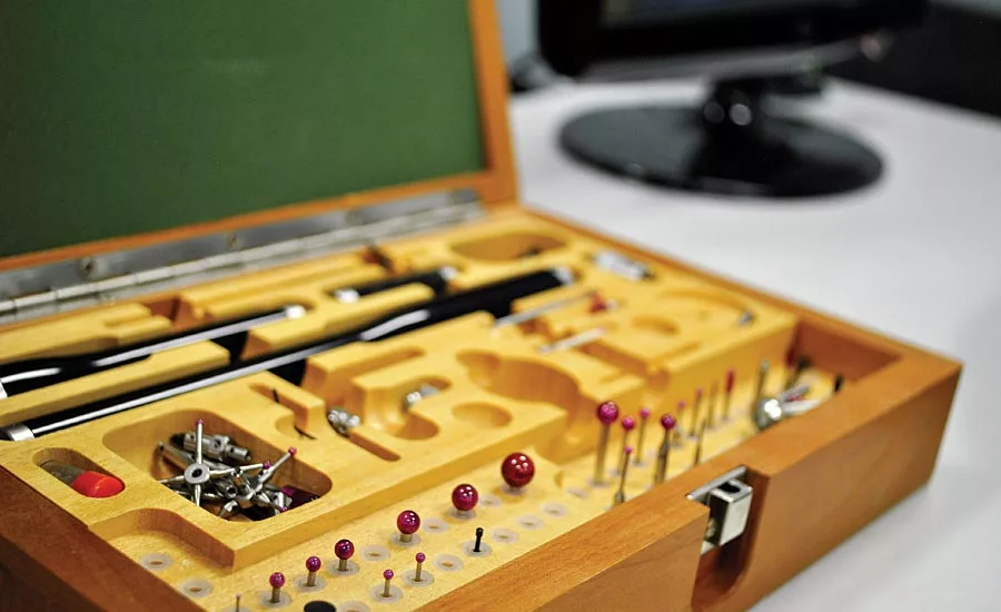

Equipment with interchangeable probes
Equipment with interchangeable probes should be calibrated each time the probe or stylus is changed.

When used properly, however, user calibration can be a valuable component of your quality system. Precision balances, for instance, often need to be regularly calibrated due to the sensitivity of the equipment and level of precision needed for the application. Devices that utilize multiple probes such as CMMs or roughness testers should be recalibrated every time the probe or stylus is changed. Following the correct protocols for these types of calibrations will ensure accurate and repeatable readings, but should be done in coordination with periodic certified calibration to ensure proper functionality. Beyond that, there are a number of things to consider before pushing the user calibration button.
