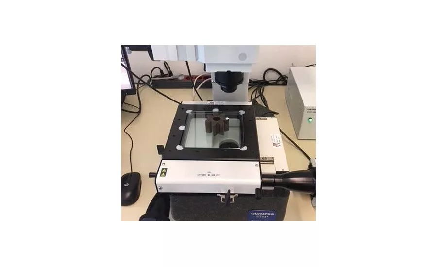

A host of tools are available to metrologists in today’s manufacturing environment. Many are simple, mechanical, and accessible to anyone who wants to measure something. Others are high-tech, even futuristic. Some, like the measuring microscope, might be considered a hybrid of the two. In addition to all the benefits measuring microscopes can bring to manufacturing applications, two very important ones—calibration and fixturing—cannot be overlooked.

“The Olympus STM7 measuring microscope is calibrated both optically for measurements on screen within the field of view, and physically by precisely calibrating the encoders built into the stage,” says Hamish Rossell, product applications manager of Olympus. “This allows it to measure across the entire travel of the stage within a known tolerance. This calibration is NIST [National Institute of Standards and Technology] traceable, providing confidence in the measurement of large and very precise parts.”

“The STM7 is available with a variety of stage options ranging in size from 50 mm square to 300 mm square,” says Lafleur. “These stages can be configured with different stage inserts including glass plates for transmitted light options and with rotating stages. As the stage insert is removable and the stage has multiple fixture points, custom fixturing is easily possible.”
In a high-volume manufacturing operation, flexible fixturing is an important asset.
“By using a fixture, the STM7’s laser autofocus, and the STM7 software’s built-in coordinate system, a component can quickly be loaded and accurate measurements acquired,” says Rossell. “As the STM7 microscope can accept multiple fixtures and coordinate maps, there’s no requirement for a skilled operator to regularly reprogram the inspection.”
