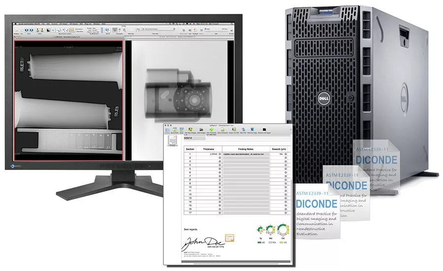

A DICONDE archive
A DICONDE archive allows for easy storing and sharing of NDT imaging and information.
