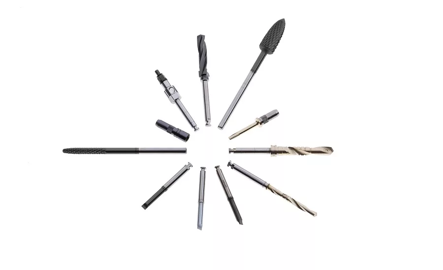

Thompson adds that the orthopedic industry was the first medical segment to realize the functional strengths of PVD coatings, as applied to surgical instruments supplied with implants. The surgical instruments coated included items such as reamers, drills, taps and broaches.

Surgeons that must perform under the harsh glare of operating room lighting have also found PVD coatings useful for its anti-glare properties. For example, Oerlikon Balzers’ BALINIT®DLC Medical and BALINIT® C (a WC/C ductile carbide carbon of the DLC family) are black or dark grey, enabling surgeons to work faster and with greater comfort in bright operating rooms.
