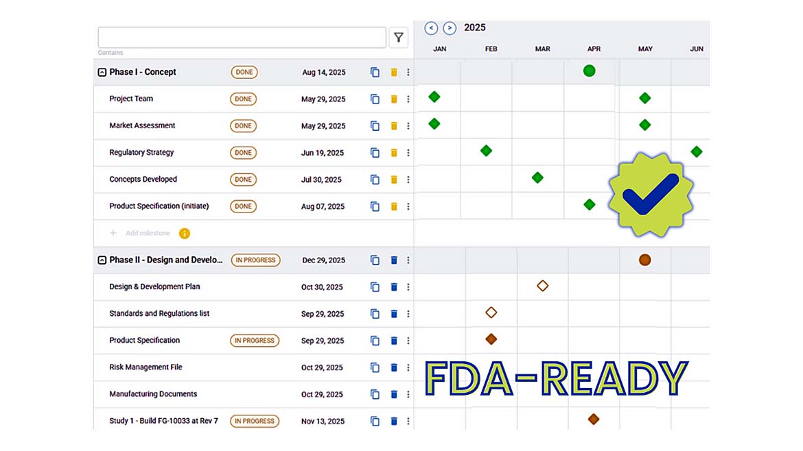

This image displays a Gantt chart dashboard outlining the project timeline for a medical device product development through 2025.
Source: Enlil
The risk isn’t simply inefficiency. Submitting the wrong version can trigger administrative holds or refuse-to-file decisions, creating downstream consequences long after development work is complete.
