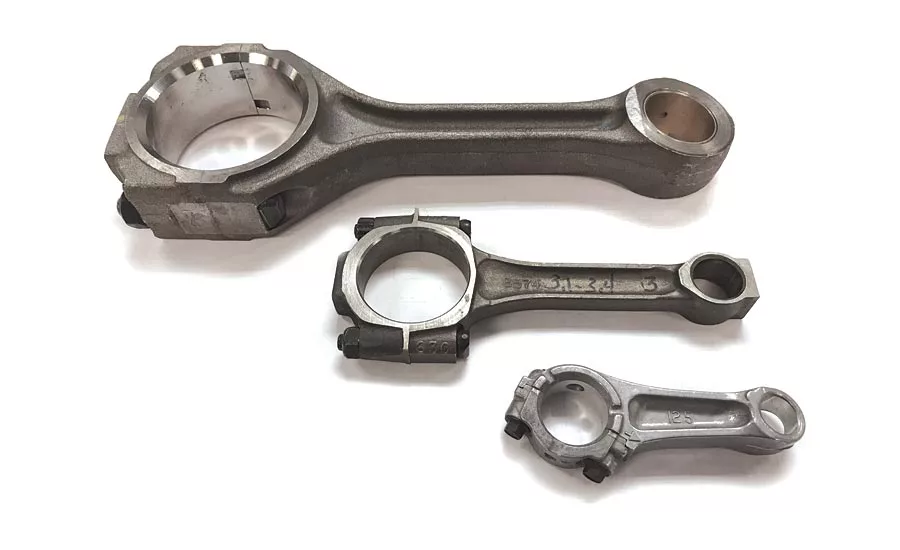

Connecting Rods
Figure 1 - Connecting Rods, an ideal application for air gaging

Air gages have somewhat of a niche application—shop floor, handheld, ID/OD inspection being the most common usage. However, these gages find other useful applications when configured for measurement of geometric features and when applied to custom fixtures. One workhorse in the automotive industry is the bend and twist gage, illustrated in Figure 2. They are also referred to as rod checkers or rod alignment checkers. These gages measure dimensional and geometric features of engine connecting rods, or conrods, as shown in Figure 1. Conrods transmit the linear reciprocating power of the piston to the rotary motion of the crankshaft.
Connecting rods are critical components of the engine and require a high degree of dimensional accuracy. These requirements apply to newly manufactured rods as well as re-conditioned rods. On engine rebuilds it is often more economical to re-condition an out-of-spec connecting rod than to purchase a new one. This is especially true when talking about six to eight rods per engine. A frequent cause of a compromised connecting rod is over revving the engine, leading to dimensional distortion and loss of clearance for sufficient oil flow. Failure of a connecting rod is one of the most common causes of catastrophic engine failure.

Conrods are inspected for parallelism of the piston-end and the crank-end bores (bend and twist), center distance, diameter, squareness, flatness of parting face, width, center distance of bolting hole, thickness of large end and small end, and roundness. These features must be in-spec for top performance of the engine and to achieve expected life. Of all the inspections required on a conrod, bend and twist are two of the most challenging without special fixtures or instruments.
The most common automotive connecting rod sizes range from 5” to 7” bore-to-bore center distance; 0.5 to 1.5” wrist pin end diameter and 2.0 to 2.5” crank end diameter. Bend and twist tolerances range from ±.0005” to ±.004”.
