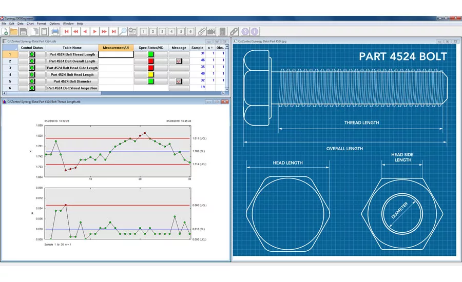

Zontec_Synergy
Synergy 2000 SPC software pulls, analyzes, and reports data in real time for company-wide quality and process improvement. Source: Zontec
