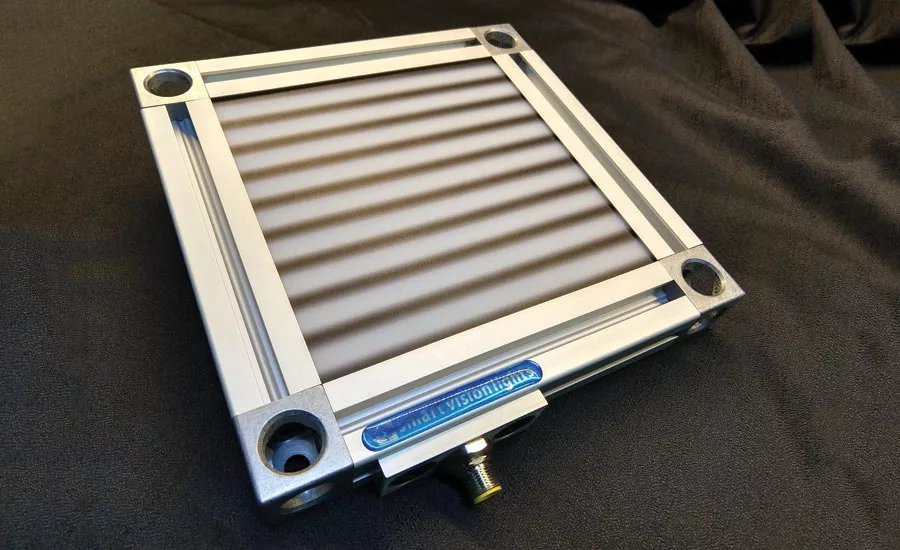

parallel gradient line pattern.
Figure 1: A 200 X 200 mm white LED PAL light features a parallel gradient line pattern.

The biggest difference between PAL and other lighting methods is that PAL captures both shape and defects in a single image on surfaces that are typically difficult to illuminate. Printed directly on the surface of the light, PAL patterns are available on area and edge-lit lights. Printed patterns are not limited to just straight lines. Circles, squares, checkboard or even a zig-zag line pattern can be used to bring out hard-to-detect flaws.

Although PAL is a variant of a standard backlight (figure 1), the way it’s applied is much different than a standard backlit application. Unlike a standard backlight, PAL can be used to inspect partially to highly reflective objects such as painted surfaces and metal parts. The pattern from a PAL light is reflected off a surface and imaged by a camera, breaking the continuity of the surface to highlight defects that are difficult to see.
