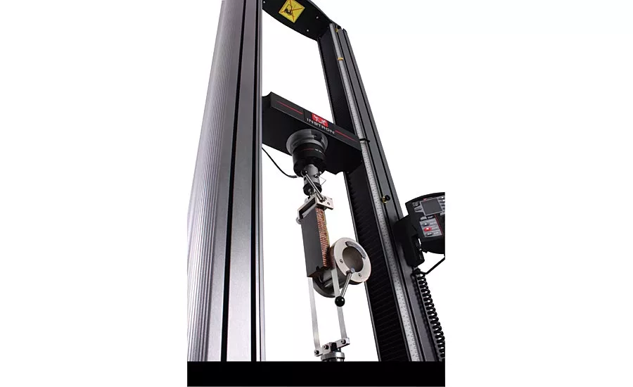

Climbing drum peel fixture, ASTM D1781

Composite laminate structures are notably weak between carbon weave layers where most of the strength is dependent on the strength of the epoxy used in the construction. A variety of fixtures can be used to determine the strength of this bond as well as the shear strength of the layers themselves.
Inter-laminar shear strength (ASTM D2344, ISO 14130) is typically tested in a guided flexure configuration, while the testing of layers between composite structures is performed with other fixtures such as sandwich flatwise tension fixtures (ASTM C297) and climbing drum peel fixtures (ASTM D1781).
