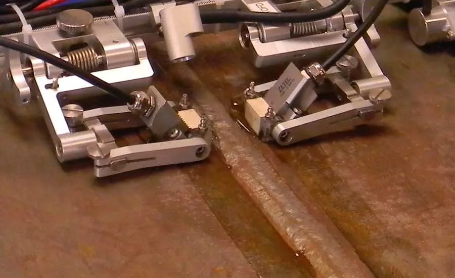

Time-of-flight diffraction is a rapid and robust ultrasonic technique for initial screenings of base material and welded regions.
In a TOFD system, ultrasonic probes are situated on opposite sides of a weld. One probe acts a transmitter, emitting an ultrasonic pulse into the material, the other functions as a receiver.
Instead of measuring only for the high amplitude sound waves that reflect off the back of a component, TOFD calculates the response time of low-amplitude waves that are diffracted by the tips of discontinuities.
The simultaneous use of phased array UT and TOFD can detect all welding flaw types and provide reliable through-wall sizing in one inspection. The inspector can use a two-sided phased array UT examination with standard shear-wave phased array probes to detect planar and surface-breaking flaws, while the TOFD technique can accurately locate and size embedded flaws.
Because TOFD has a high degree of repeatability, changes in degradation can be recorded and compared over time. Using phased array UT and TOFD together can also increase the productivity of the inspection crew simply by reducing the number of scans and manipulations that need to be done.

At a minimum, the scanning device required to support the simultaneous encoded application of PAUT and TOFD needs to support four search units (two phased array UT probes and one TOFD pair).
However, as the thickness of the material becomes greater, the TOFD inspection needs to be done in different depth zones and therefore requires more TOFD probes and larger probe-center separation to cover the full volume of interest.
In order to maximize the efficiency of the inspection crew, which often has to inspect thin-wall and heavy-wall components in the same shift, the scanner should allow the flexibility to support a wide range of thicknesses.
