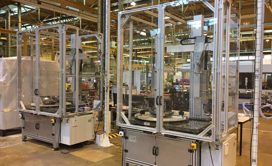

Figure 1. Automated Eddy Current Scanner with 3D Scanning Capablities

Aero-engine discs are very critical parts since they are exposed to high stress and temperature during flights. Engine disc components such as bearing rings, fan and compressor discs are subjected to extensive inspections during the different manufacturing stages, including dimensional controls up to the detection of the tiniest surface flaws on rolling surfaces (bearing raceways). The forging process, with which most of these parts are formed, is a high energy process that can result in many different types of defects, some of these being near surface or surface breaking cracks. Thus, complementary NDT technologies such as ultrasonic, liquid penetrant and eddy current testing are commonly used for flaw detection on those components. However, as the shapes and materials of these parts become more and more complex, automated inspection plays a crucial role in ensuring that these parts are defect free. To overcome the above-mentioned challenges, this article demonstrates an automated eddy current solution with 3D scanning capabilities developed to inspect aero-engine forged discs.
Automated Eddy Current Testing
Eddy current testing technique plays an important role in quality control of aero-engine components. When inspecting with automated eddy current scanners, surface as well as some sub-surface flaws are detected by scanning the surface of the inspected material. Such scanners are usually Cartesian scanners built with rotational axes and designed to perform high speed and repeatable nondestructive testing. However, forged discs have complex shapes with multiple surface transitions that make it difficult for simple 2-axis and rotational scanners to perform inspections of these parts. In order to achieve the desired inspection results under these circumstances, automated eddy current solution with advanced 3D capabilities needs to be used to perform full scans on aero-engine discs. Tridimensional inspection of these discs is best achieved using computer-aided design (CAD) files to perform accurate inspection in the 3D space.
FIGURE 2: Turntable with centering mechanism
3D Eddy Current Testing
To overcome the above-mentioned part geometry and inspection challenges, an automated eddy current testing solution with 3D scanning capabilities is proposed. The developed solution is engineered around a mechanical scanner, an eddy current instrument, a turntable and a relatively small, high frequency eddy-current coil that is scanned across a selected or the whole disc surface. During scans, the turntable rotates the engine disc, while the probe is being moved in the 3D space while maintaining constant lift-off and perpendicularity with the tested surface until the automated inspection is finished. Turntable rotation speed is continuously adjusted to maintain a constant linear scanning speed on the surface and based on the radial position of the probe on the surface. This is essential to maintain correlation between the signal obtained during the scan and the signal obtained during the calibration phase on one or multiple reference notches. During this operation, the system records the eddy current signals and the associated scan positions for C-scan analysis and reporting.
The mechanical scanner axes (Z, Y, Gimbal and Turntable) as well as the turntable centering mechanism are all highly accurate and repeatable and this allows for advanced features such as return on defect, constant linear inspection speeds, inspection and surface following at the optimized probe squint angle, and other features. The gimbal axis is designed to absorb vibrations and is equipped with two encoders that monitor angular as well as probe lift-off position, ensuring that the eddy current signal is constant throughout the entire inspection.
The system also integrates a support for calibration standards, allowing the operator to adjust the instrument sensitivity by running automated scans on the standard section, without having to remove the part under inspection, which is particularly useful if sensitivity has to be verified while scanning a part.
