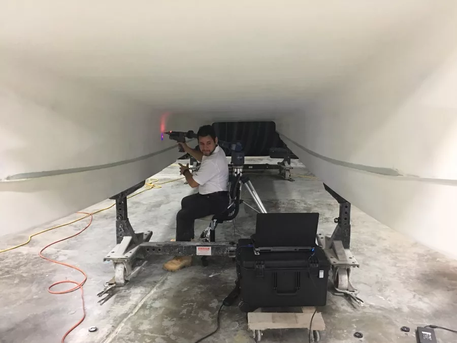

The tracker is used to bring all of the portable arms into the same coordinate system.

Clay Ratcliffe, Porta Performance’s project lead said, “The FARO Super 6DoF TrackArm Technology was the perfect choice. After reviewing and performing test scans with the available technologies, it was the only system that did not require any compromise between the physical size of the job, the accuracy over that volume, any line of sight challenges caused by the size and shape of the subject matter and the resolution required to adequately capture the complex surfaces.”
