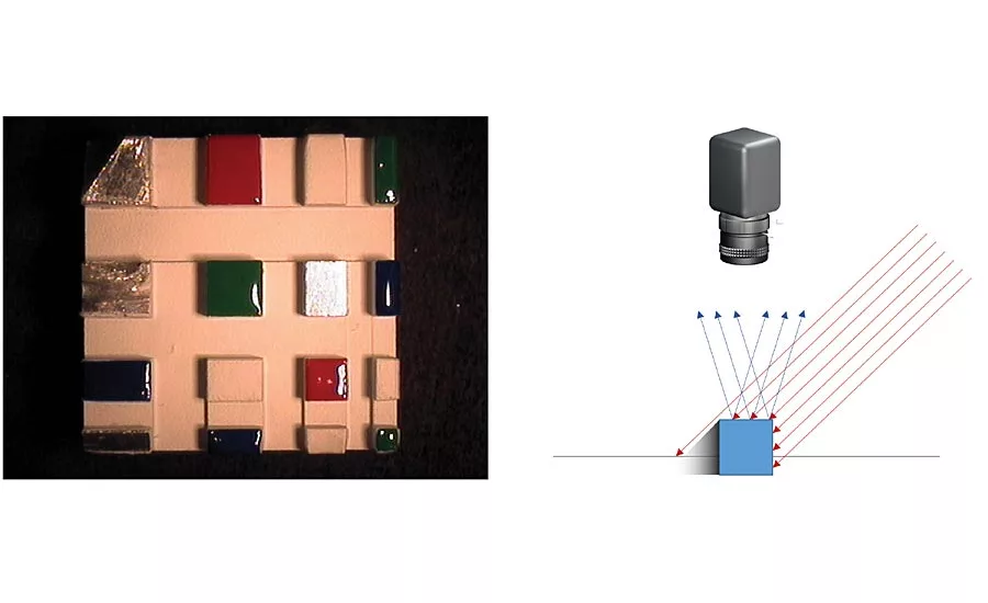

directional illumination
Figure 1. When using directional illumination, a light source is positioned at an angle to the object such that the object scatters light rays upward toward the camera, but also casts a significant shadow.

One lighting technique is called directional brightfield illumination. Directional illumination uses a single or multiple light sources positioned such that the light rays are traveling in a single direction at some moderate angle with respect to the line-of-sight of the camera and brightfield illumination refers to the background of the object being brighter than the object (Figure 1).
This corresponds, for example, to standard orientations one might use to capture casual images with a cellphone: the light source being the sun, shining above and behind the photographer, distributed evenly on the subject. This imaging geometry is straightforward in setup and resulting photos show object detail but hide or obscure features in shadow or with glare. The same characteristics apply in machine vision.
