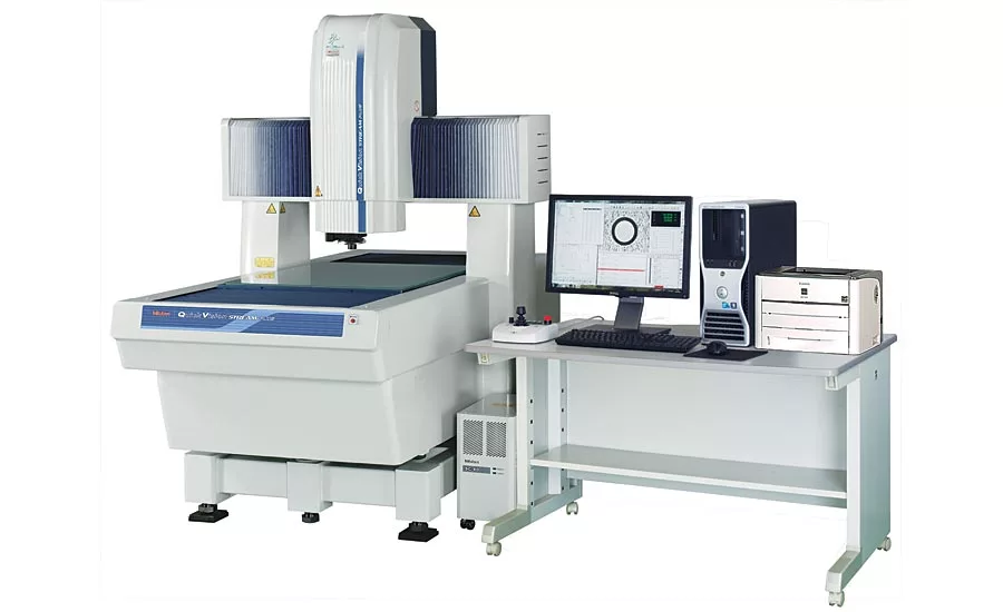

Vision Measuring Machines
These optical inspection machines are built on a platform with at least three axes and at least one objective lens. Using a computer to automatically detect features and calculate measurements from those detected features, vision measuring machines are most often computer-controlled although manual models do exist.
In addition to a machine frame or base with at least three axes and an objective lens, all vision measuring machines have an image detector and a computer. The frame holds the part being measured along with the lens and detector. The detector itself interprets light gathered by the objective lens and transforms it into an electrical signal that the computer then uses to calculate dimensions based on measured edges (e.g. distances, diameters, etc.). The detector is either a charge-coupled device (CCD) or a complementary metal oxide semiconductor (CMOS).
Unlike profile projectors/optical comparators and most measuring microscopes, vision measuring machines use computers for control and edge detection and, therefore, require software. In CNC vision measuring machines, the software drives the camera to a given location on the part being measured and detects points on edges and surfaces in the field of view of the camera. The software then uses the detected points to construct features such as lines and diameters. Most vision measuring machine software can also output ASME or ISO tolerancing (e.g. true position, parallelism, etc.) and can usually output measured values in various formats, including text file output, direct to SPC and more.
Because vision measuring machines have some limitations regarding what features can be measured, additional sensors are often added. The most common being a touch probe, which allows the machine to function similarly to a coordinate measuring machine (CMM). Lasers can also be added to speed or improve the accuracy of Z-axis measurements or for the purposes of 3D scanning. In terms of 3D scanning, chromatic position sensors (CPS) can also be used and, though not a sensor, focus image stacking, also known as points from focus, can be added to enable the standard vision measuring machine camera to generate a 3D scan of any part being measured. Finally, white light interferometry (WLI) can be added to generate a 3D scan using interferometry rather than focus stacking.

Advantages: Vision measuring machines have a high throughput and are ideal for measuring parts too small for a CMM (vision measuring machines are as accurate, yet faster), or for parts that cannot be touched due to contamination or flexibility reasons. In comparison to profile projectors/optical comparators, vision measuring machines can see and measure the same features in a faster and more accurate manner. In comparison to microscopes, vision measuring machines typically have larger working distances, larger fields of view and larger measuring envelopes. And while modern vision measuring machines will always come with automatic edge detection and computer calculated measurements, microscopes typically only offer these features as optional add-ons.
Disadvantages: The main drawback of vision measuring machines is that they are the most expensive type of optical measurement device on the market. Vision measuring machines also have lower resolving power than microscopes and typically do not offer magnifications as high as microscopes do.
