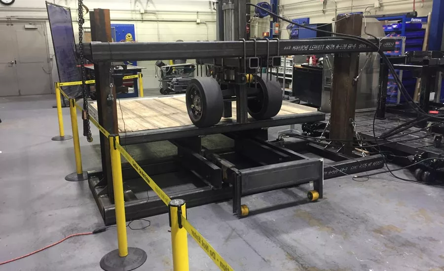

Box van floor test apparatus
Figure 1. Box van floor test apparatus. The wheels are held in position, pressing downward on the floor segment while it is moved back and forth underneath.

“Most of the safety tests performed are ensuring that a particular standard is met, for example there are floor load standards,” said Pelnarsh. “There is a floor loading test where we have to run a simulated forklift of 9,000 pounds moving across a truck floor 10,000 times.” The floor being tested (see figure 1) is made from wood, which would be found in a standard box van product made by Knapheide.

There are two motion axes being controlled in the box van test stand. The motion controller operates the hydraulics through a proportional servo valve feeding the cylinder that applies down force on the wheels. It also controls the hydraulic motor that moves the truck floor back and forth (instead of moving the simulated forklift, it was easier to move the floor). During the test, the down force is ramped up and down as the floor is moved. “What makes this application complex is that the motion of the floor and application of the force through the wheels needs to be precisely coordinated as they are cycled,” said Pelnarsh.
The motion controller connects directly to a rotary encoder on the hydraulic motor to keep track of the number of cycles, and a load cell on the hydraulic cylinder that tracks the pressure being exerted by the forklift wheels. Because the RMC 151 is a multi-axis controller it can synchronize, or time sequence the motion of up to eight motion axes simultaneously.
