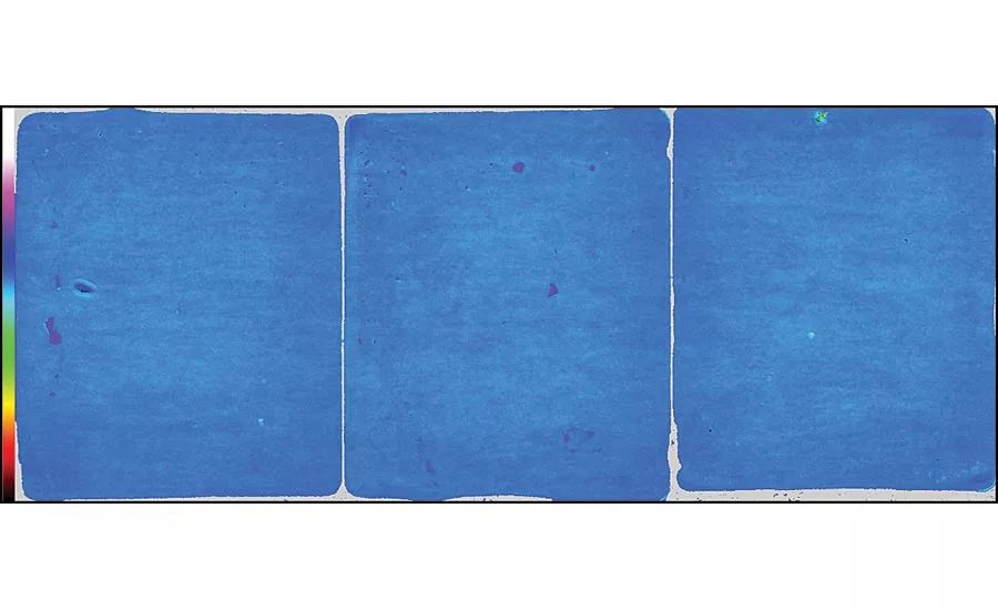

C-mode image
Figure 1. C-mode image in which blue indicates good bonding of solder to the ceramic layer in an IGBT module.

Figure 1 is the C-mode image of an IGBT (Insulated Gate Bipolar Transistor) module having three ceramic rafts. C-mode was used to determine whether, and how well, the solder was bonded to the ceramic layer below it. The amplitude of each returning echo was measured and assigned a color. The resulting image of the whole module uses only a tiny part of the range of colors available in the color map at the left margin of the image. Conclusion from C-mode imaging: virtually the total area between the solder and the ceramic is well bonded. There are no significant voids or delaminations between the solder and the ceramic, and the likelihood of a field failure from such defects is tiny. But higher magnification of this sample revealed small voids and other small anomalies.

Figure 3 is the Time Difference image of the center component in Figure 1. Figure 1 reveals that the bond between the solder and the ceramic has few if any significant disbonds, but Figure 3 reveals that the bond between the solder and the ceramic is tilted and warped in two dimensions. The thickest regions are white, while the thinnest regions are red. The numerous scattered features are voids in the solder.
