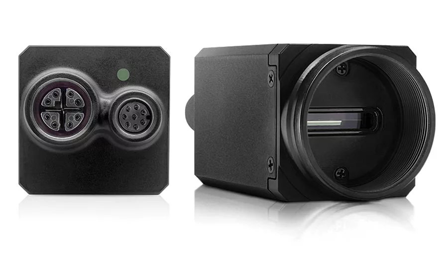

Lucid Vision Labs, Inc., announced the series production of its new 2K line scan Triton GigE Vision camera.
The Triton line scan camera is the newest addition to the Triton series, featuring the “2K AMS Dragster DR-2k-7” monochrome line scan sensor with a 7 µm pixel size and a resolution of 2048 x 1 at a line rate of 60 kHz. Additional features such as IP67 protection, a robust M12 Ethernet GPIO connector, Power over Ethernet (PoE) and a temperature range (0°C to 55°C ambient), ensure a reliable operation in demanding industrial environments. Due to its lightweight, compact 29 mm x 29 mm size, the Triton line scan camera is smaller than most line scan cameras on the market and can easily fit in nearly any application. All Triton cameras feature active sensor alignment that helps to minimize sensor tilt and rotation for a maximum image sharpness.
All Lucid cameras conform to the GigE Vision 2.0 and GenICam3 standards and are supported by Lucid’s own Arena software development kit. The Arena SDK provides customers with easy access to the latest industry standards and software technology. The SDK supports Windows, Linux 64bit and Linux ARM operating systems, and C, C++, C# and Python programming languages.
