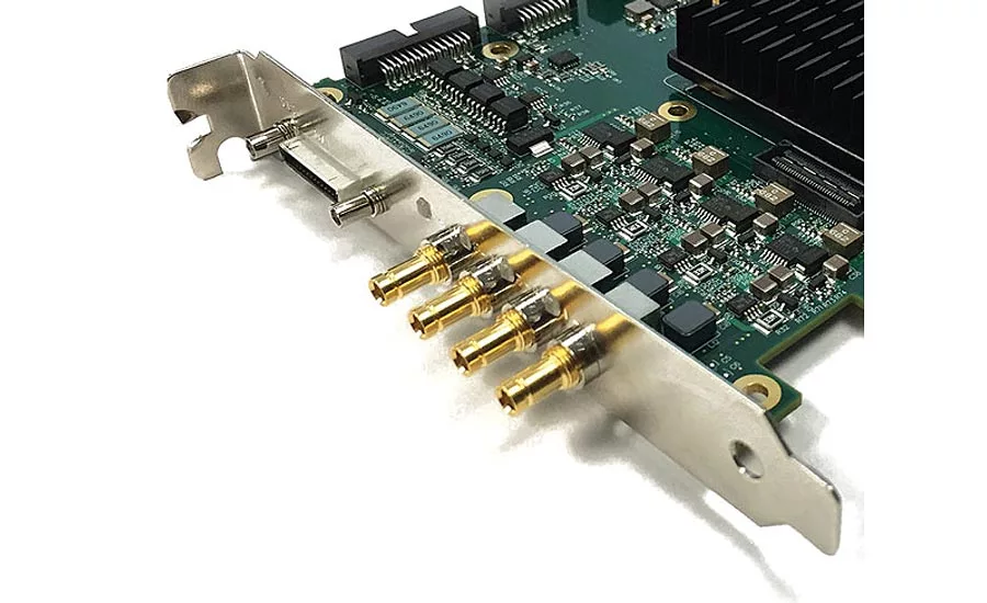

Teledyne DALSA announced its Xtium™2-CXP series of high-performance frame grabbers. The new series transfers image data to the host memory at maximum acquisition rates with zero CPU utilization, allowing host applications to operate at maximum efficiency.
The Xtium2-CXP series is compatible with CoaXPress® version 2.0 and uses the PCI Express Gen3 x8 platform to deliver sustained image acquisition bandwidth of up to 6.8 GB/s to the host memory. The Xtium2-CXP frame grabber series supports image acquisition rates of up to 12.5Gbs and models are available in 4, 2 and 1-channel configurations. The Xtium2 series is fully supported by Teledyne DALSA’s free Sapera LT SDK.
With its 2 GB of image memory, the Xtium2-CXP prevents data loss when the PCIe bus is being utilized by other devices in the system, and data cannot be transferred for processing. Fully compatible with Teledyne DALSA’s Trigger-To-Image Reliability (T2IR) framework, the new CXP boards deliver ready-to-use images and support both area and line scan monochrome, RGB and Bayer color cameras.
When combined with the industry’s newest and highest resolution cameras, the Xtium2-CXP series frame grabbers enable some of the most demanding vision applications.
Xtium2-CXP Key Features:
  • Half-length PCIe Gen3 x8 board, with 4 micro-BNC coaxial connectors
  • Maximum image acquisition bandwidth of up to  5.0GB/s, maximum host bandwidth up to 6.8GB/s
  • Supports CXP 1.x and 2.0 cameras with 4, 2 or 1 output channels of up to 12.5Gbs/ channel
  • Simultaneous acquisition from multiple independent cameras
