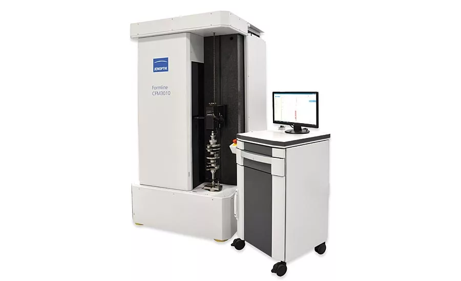

Typical CCMM shaft gage

What Kind of Gage is This?
Dedicated shaft gages are also known as cylindrical coordinate measuring machines. According to Wikipedia, a “cylindrical coordinate measuring machine or CCMM, is a special variation of a standard coordinate measuring machine, (CMM), which incorporates a moving table to rotate the part relative to the probe. The probe moves perpendicular to the part axis and radial data is collected at regular angular intervals.”

Cylindrical CMM shaft gages typically hold the part between mechanical centers, with one of these centers fixed to the rotating table. A clamp or other suitable driver mechanically connects the part to the table so it may be rotated relative to the probe contact point. Although the part is captured by its mechanical centers, software is employed to correct the shaft features to a datum specified in the drawing.
The rotating table is where the CCMM shaft gage gains its advantages. By rotating the part using a precision spindle, we reduce some of the sources of error in a conventional CMM. How precise that spindle needs to be depends in large part on what parameter you are measuring. If a precise roundness (form) measurement is required, then precise control of the part axis is needed. Any wobble or runout in the spindle will be directly translated to the part measurement. This is because a gage that measures roundness needs to contact the part on one side only, taking a true radial measurement on a known axis.
In addition to the elimination of error stack-up, the dedicated shaft gage is typically much faster than a traditional CMM. The part can be rotated, relative to the probe, much faster than a conventional CMM can scan around each part feature.
