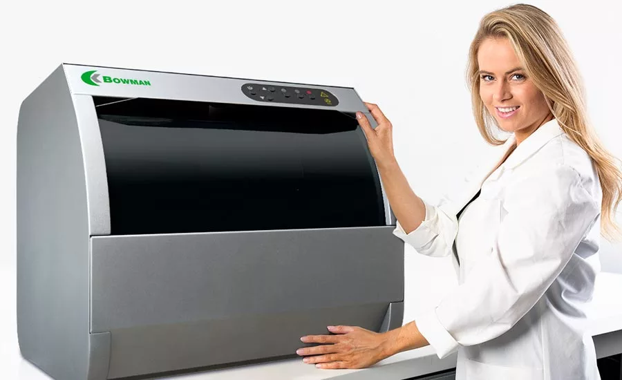

XRF coating thickness measurement instrument
This XRF coating thickness measurement instrument accommodates samples up to 22” x 24” x 13” (LxWxH). It is manufactured with an Si PIN or Silicon Drift Detector (SDD).

Many platers don’t test for phos content in-house, however, relying instead on their chemical suppliers or an outside lab. What they often don’t realize is that phosphorus can be quickly and precisely measured with XRF, a proven and familiar quality tool—if the instrument has the right detector.
XRF systems use one of several types of detectors. Among the most popular for the measurement of coatings are Silicon PIN diode detectors, which deliver spectral resolution superior to the “prop” (proportional) counters that preceded them, so thinner deposits and lower concentrations can be measured, along with multi-layered samples and samples involving “mystery” materials. Silicon PINs combine low noise, excellent resolution, low detection limits and high stability. They are “standard” for most XRF equipment lines, but they are unable to measure phosphorus.
XRF analyzers
XRF analyzers with silicon drift detectors are ideal for measuring electroless nickel and other coatings. They combine low noise, optimized charge collection, and high uniformity from detector to detector.
Silicon drift detectors (SDDs) are widely preferred for the measurement of coatings. Their count rates and spectral resolution are highest by far; they are best at detecting very low kV photons. SDDs offer substantial peak-to-background ratio improvement over the alternatives, particularly when they are paired with an X-ray tube that uses optimal target material. They can also measure phosphorus, and everything else on the periodic table between sodium and uranium. The only downside is their higher cost.
For a plater that wants—or whose customers demand—verifiable phos numbers, the SDD is a slam-dunk. For shops that envision more—or more tightly specified—EN in the future, there’s a conundrum: make the added investment now, or wait.
Fortunately, there’s a new middle ground. Companies can opt for a lower cost XRF with an Si PIN detector—a system that will measure every major industrial element except phosphorus—and, if and when it becomes important to measure phos precisely, or inline (or at least in-house), swap-out the Si PIN detector for an SDD.
