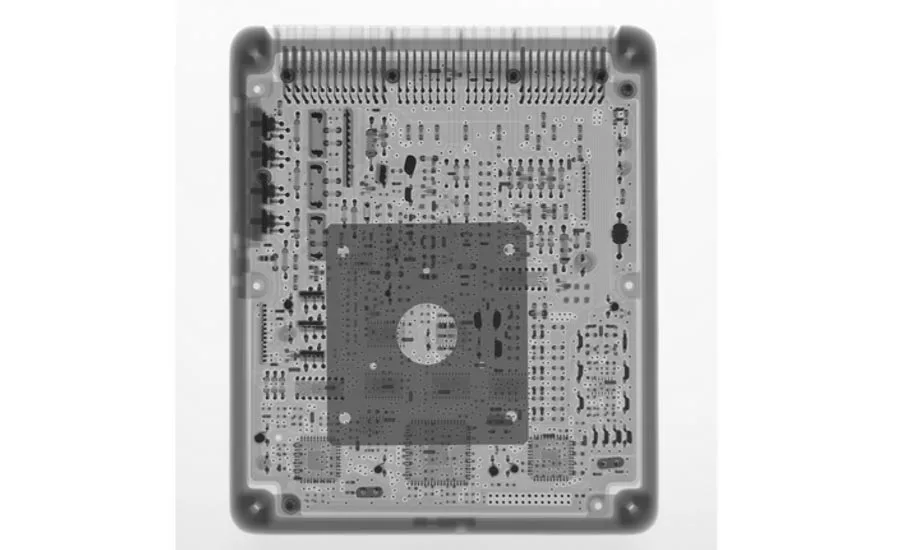

Figure 1 shows a two-dimensional X-ray image of an ECU scanned using a microfocus X-ray CT system. Two-dimensional inspection can find obvious imperfections, such as missing or damaged components and significant bends in the parts. The position of the board can also be identified, making it possible to check for physical contact between the board and the ECU case.

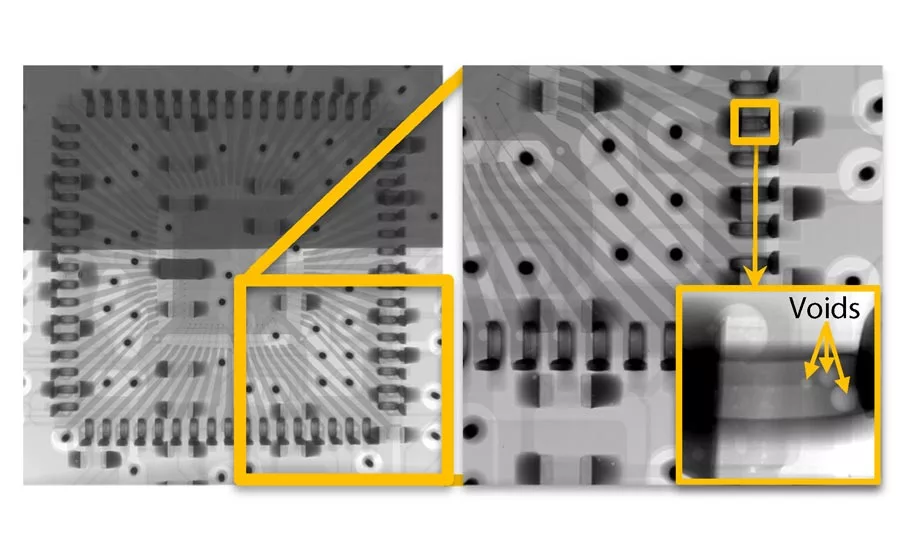

The internal structure analysis of electric components and more detailed solder joint inspection can be performed by increasing the magnification ratio. For example, figure 2 shows two-dimensional X-ray images of the area around an IC package (left) and a solder joint area scanned at a higher magnification (right). The internal wiring in the IC package and the solder joints are resolved on the left side, and voids in solder joints with the board can also be confirmed by further enlargement of the solder joint area on the right.

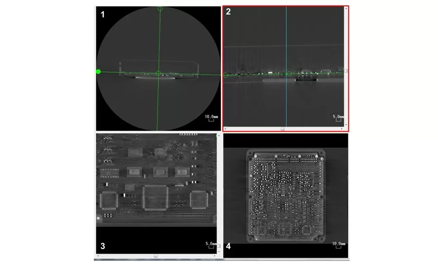

In addition to two-dimensional X-ray images, multi planar reconstruction (MPR) images can be obtained. MPR is a function that reformats a CT volume data set at arbitrary planes by virtually stacking Z-axial slices. As shown in figure 3, it is possible to display the CT image, as seen in (1), and cross-sectional images mutually orthogonal to (1), as in (2) and (3). This can also be done with cross-sectional images from any arbitrary angle, as in (4). In a CT image, lighter (whiter) areas represent structures, such as solder joints, electronic components, and the wiring of the board, having higher densities. Thus, one can confirm the presence or absence of parts and solder from this general image in three dimensions.

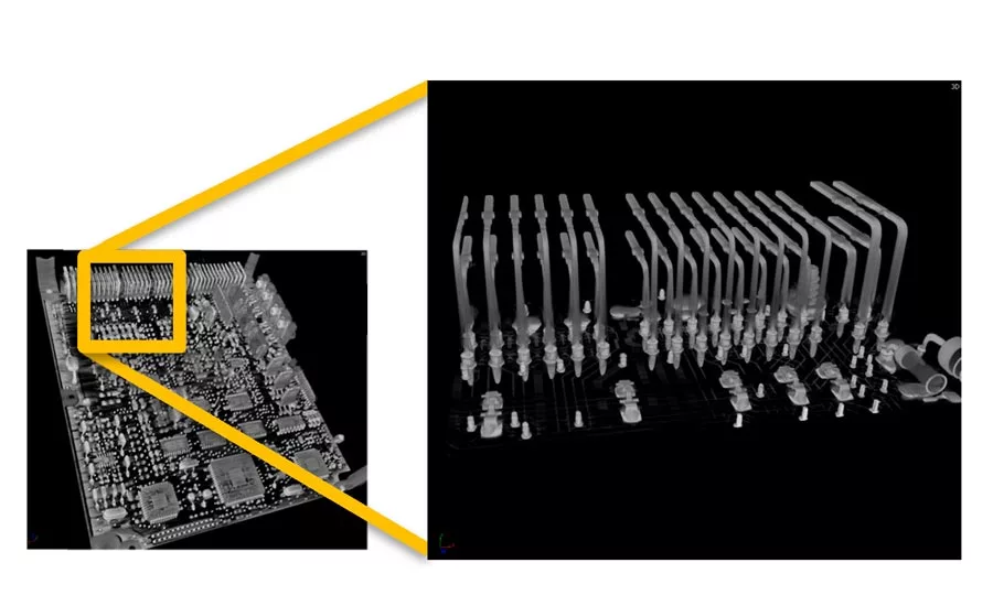

By utilizing specialized analysis and visualization software for industrial CT data, one can display a 2D projection of a 3D data set acquired using a CT scanner. This technique is called volume rendering. Using this technique, bent parts and the presence (or absence) of parts on the back side of the board can be intuitively visualized in 3D. This allows the operator to observe a shape closer to that of the actual object.
As an example, Figure 4 shows a magnified volume rendering image for solder joints of a connector. Although solder joints are used at many of the terminals, voids in the solder (if present) may coalesce and develop into cracks due to the repeated vibration and thermal expansion inherent to the operation of the automobile.

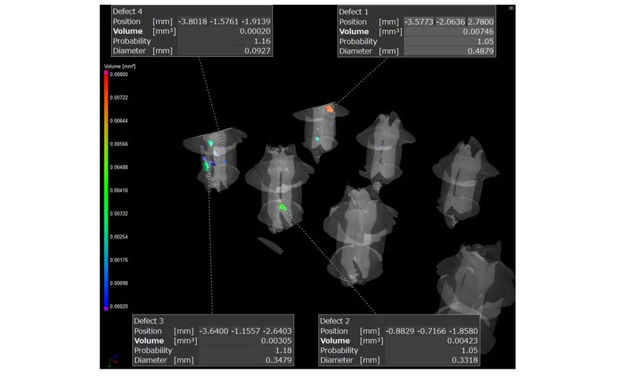

Figure 5 shows the characterized void distributions in solder joints. The voids are color coded by volume. Visualizing individual voids, identifying their locations, and calculating their respective volumes and surface areas enables objective, quantifiable measurement of quality control. By ascertaining the condition of defects from various types of quantified information and adjusting the reflow conditions accordingly, significant improvements in production yield and efficiency can be achieved.
