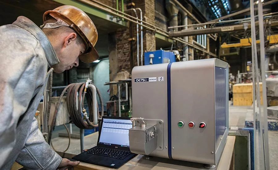

man in hard hat with laptop
The continued development of analytical technologies is making materials testing easier for companies across the automotive industry.

Optical emission spectroscopy (OES)
How it works: OES excites the molecules in a sample using electricity to measure the relative proportions of each element in a sample. There are two variants: spark—a series of multi-discharge events where the voltage of the electrode is switched on and off; and arc—a single on/off event similar to a lightning strike.
What it measures: The technique can only be used to test metals; however, it can measure non-metallic elements within them, notably carbon, boron, phosphorous and nitrogen in steel.
Strengths: OES devices offer the highest levels of accuracy, with detection to very low levels for all the important elements.
Weaknesses: OES will leave a burn mark on the sample. It also requires argon gas canisters, unless used with an arc probe.
