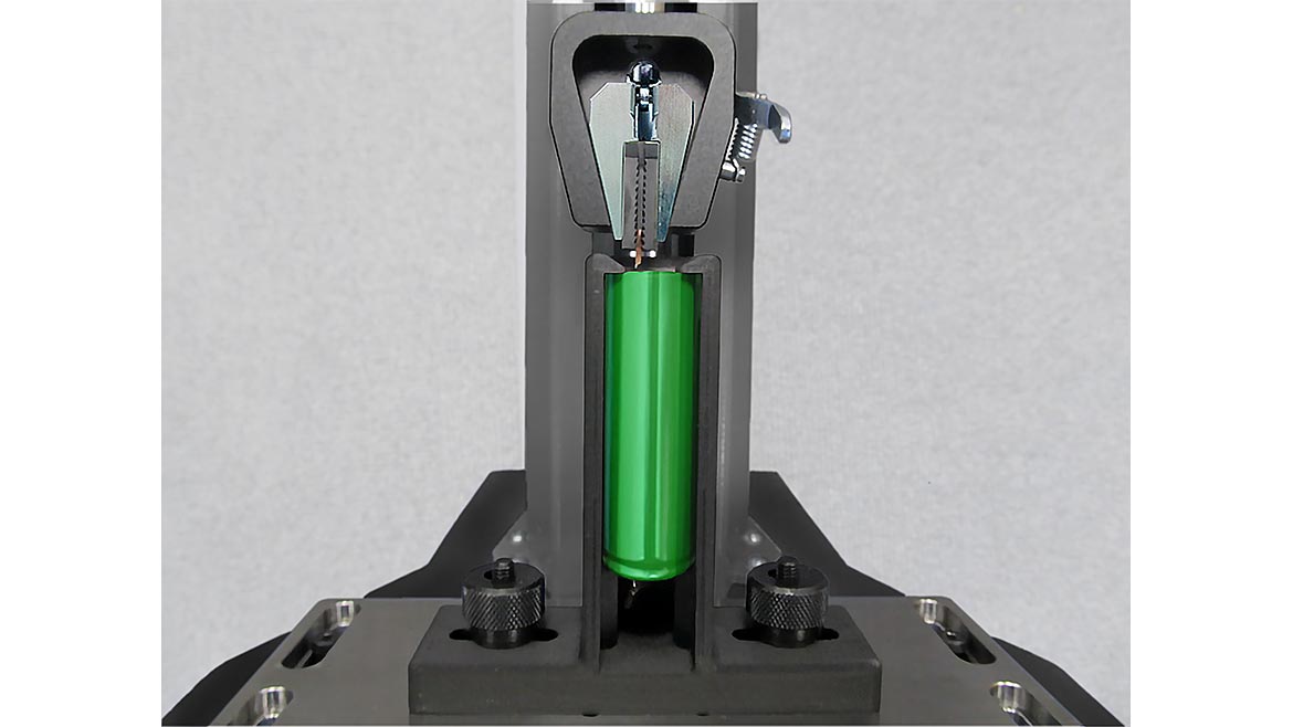

Tensile testing of electrodes to current collector interconnects
Electrodes and current collectors play a crucial role in battery efficiency by facilitating electron flow. These components are often made from materials such as aluminum (for cathode) and copper (for anode) foils, which require precise mechanical properties to maintain electrical conductivity while withstanding mechanical stress. The bonding between the electrode plate and the terminal tab or [bond] wire interconnect is also checked in this procedure, which highlights the weakest link in either raw material or joint.
A pull-off tensile test on the terminal interconnect tab at the cathode (positive) end of a cylindrical cell battery. The axial force is consistently increased until failure, which may be the tab material itself or its welded joint to the casing, and the peak load is recorded. Efficiency and repeatability of testing a batch of battery samples is enhanced by use of a custom-built fixture to load, secure and release the cell. A serrated-toothed jaw self-tightening wedge grip ensures the metal tab does not slip.
Terminal tab pull off post test quick release.
Terminal tab pull off post test front view.
Terminal tab pull off post test.
A pull-off tensile test on the terminal interconnect tab at the cathode (positive) end of a cylindrical cell battery. The axial force is consistently increased until failure, which may be the tab material itself or its welded joint to the casing, and the peak load is recorded. Efficiency and repeatability of testing a batch of battery samples is enhanced by use of a custom-built fixture to load, secure and release the cell. A serrated-toothed jaw self-tightening wedge grip ensures the metal tab does not slip. All Images Source: courtesy of Mecmesin, a PPT Group company

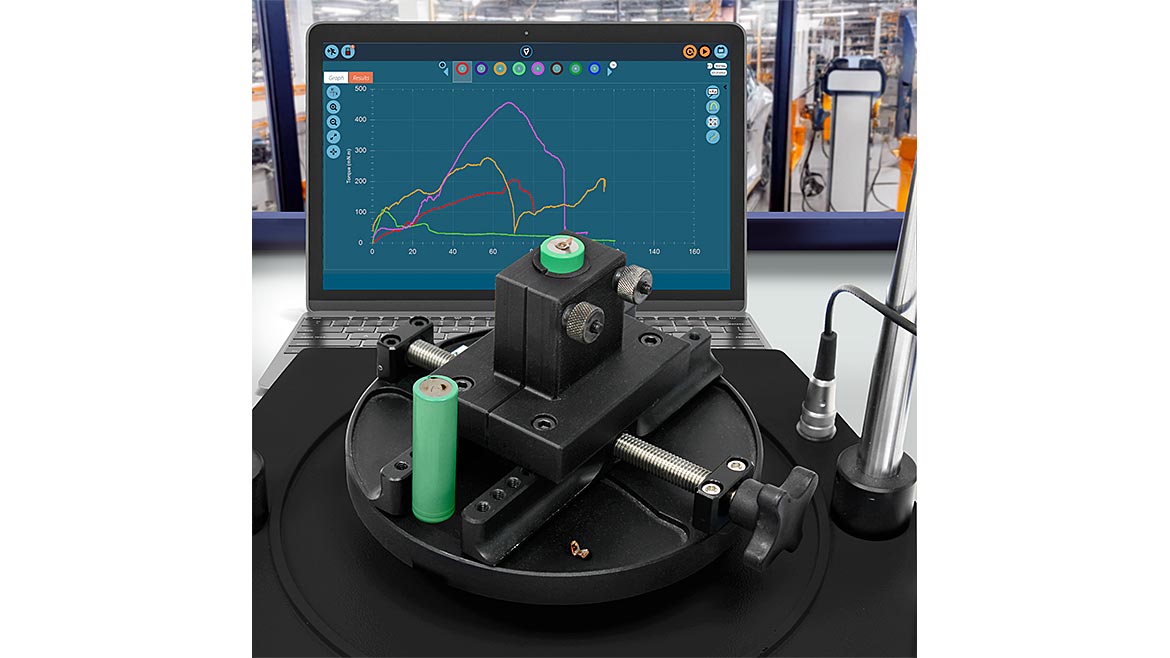

Torque testing of electrodes to current collector interconnects
A twist on the mechanical integrity test of current collector tab manufacture is to again test to failure but by the application of a torque rather than an axial force. The vibration experienced by the battery pack in service will be random in nature and manufacturers take advantage of software-controlled systems to implement a variety of loadings in order to thoroughly test a component’s resilience.
A twist-off test measures the torque required to make the electrode tab fail. An adjustable clamping fixture grips the cell’s exact geometry enabling meaningful comparative testing of batches.
Battery terminal twist off with tested sample VortexPro.
A twist-off test measures the torque required to make the electrode tab fail. An adjustable clamping fixture grips the cell’s exact geometry enabling meaningful comparative testing of batches. Image Source: courtesy of Mecmesin, a PPT Group company

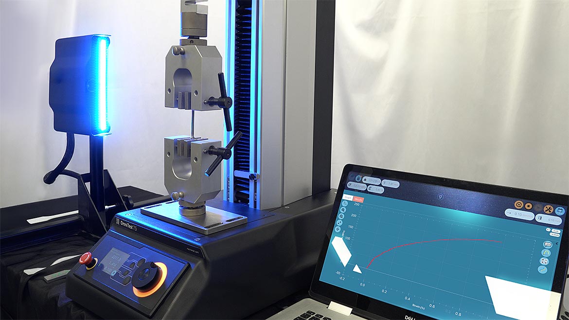

Measuring the stress-strain behavior to the point of failure of a standard dumbbell-shaped material test piece is the fundamental method of determining a raw material’s physical strength. The specimen is put under tension and calculations based on the load-elongation curve is used to quantify benchmark properties. Understanding how a new material with improved electrical efficiency might be impacted in terms of mechanical strength is a vital insight. Changes to the structure to elicit gains in conductivity, ductility, ease-of-bonding or thermal behavior must be evaluated against any significant loss in robustness.
Metal dumbbell break test 02.
An established tensile load-displacement test on a metallic raw material test piece. Accuracy of calculated physical properties is important where fabricated components are part of an EV system, as efficiency improvements are at the forefront of current research and development objectives. This system employs a video extensometer which measures the true strain (elongation) of the test piece without contact, optimizing the accuracy of the measured value. Image Source: courtesy of Mecmesin, a PPT Group company
